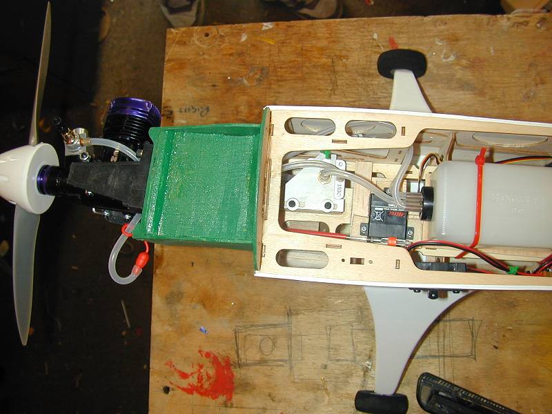

Not if you use a pressure regulator, you can also move the tank back too the C of G, the one in the pic is by Webra.

Which regulator is pictured? Where to buy?
How does it work?
How much do they $$
