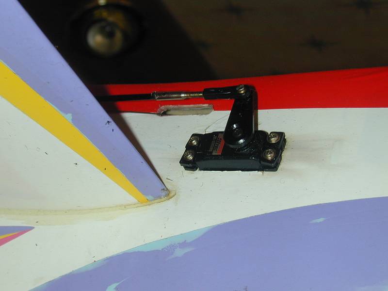

Old 07-23-2008 | 06:57 PM
Zippi's Avatar
My Feedback: (10)
Joined: Jun 2004
Posts: 4,977
From: Evansville, IN
Default RE: dual elevator servo
selnekav,
As you can see by the pic, there is an open bay rear of my elevator servo. On the other side the other elevator servo is in that open bay 2 1/2" behind the other elevator servo. It is mounted right under the rudder servo. I have no problems with this set up and both elevator servo have the same traval.
