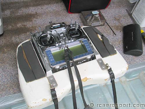

I found this picture of CPLR's radio (at www.rcaerosport.com). The sticks are really long (that explains the unusual expo in his setup), but more intriguing is that it is in mode 2! I always thought all top flyers used mode 1....

Actually most of the top fliers are mode 2, arn't they?
Quique, CPLR, Hyde, Shulman, McMurtry,etc
Roland Matt uses mode 1 I think, I guess it just depends where you learn to fly rc.
I bet you will also find that the springs in CPLR's radio are quite stiff.
Theoretically (IMO), the most precise way of moving the sticks, is with a tray, long sticks, and high spring tensions.
That along with a bit of expo really helps delete unwanted shakes, or movements of the sticks.
It also gives you a really good feel for the centre position of the stick.

Actually he used very High expo...(I believe) and the long stick has the same effect of removing sensibilities around neutral...so he must have too make fairly large movement to have a strong servo response.

Folks
I have flown CPLRs models using his radio, for many years.
The stick tensions are not high, I would say average.
The reason for the extensions, is because futaba sticks are short and designed for thumb fliers. CPLR is a finger and thumb flier.
With the use of a tranny tray, it is virtually impossible to fly finger and thumb on the standard sticks.
I use a similar system but with a diff tray layout which means I can rest my palms on the side of the tranny case, but I use stick extns, although only such that they fit between the bottom and top of the normal futaba sticks.
hope this is of use to you...
PS - Many european fliers fly mode 1. Perhaps one reason CPLR and his club mates fly Mode 2 is because their founding members were taught by a british club !?
