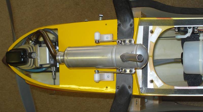

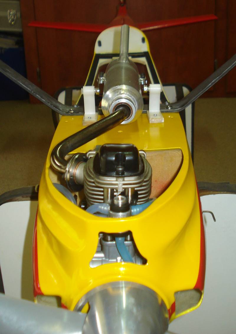

Instilation with Hyde softmount and nose ring-installed new firewall more aft. AUW 3,7 kg. Lovely little plane with tons of grunt.
Enjoy
Gerrie

gerrie, Looks great! What header is that and what pipe are you using? I've been wanting to get an exhaust system for my Y.S 110s. Thanks!

Hatori 725 muffler
Hatori 726 header - both from Central hobbies
Nose ring from [email protected]

What rise is your Nishioka mounting kit? Where did you get it as well?
Thanks!

Rise is 37 mm sitting on top of two small 5mm balsa blocks. APC 14-11 more constant speed - about 9000 rpm.
Morgan Coolpower LV 30 persent. Not as thirsty as the YS 170 and easier to transport.
gerrie

The Nishioka pipe mounts can be found here: http://www.elation-f3a.co.uk/shop/ca...ram=cid%3D5%26
