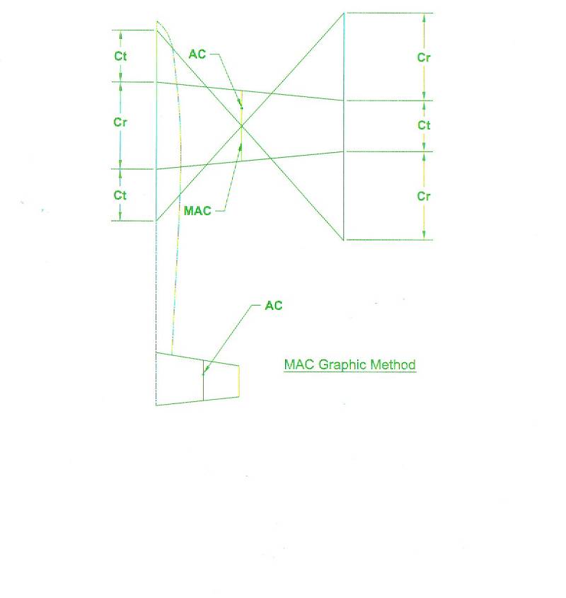

Default RE: incedence setup
Hi Buka.
Please take a look at this:
Nat Penton Trim without Mix Drawings
http://nsrca.us/all/flying/254-pento...-drawings.html
Regards,
Federico
ID:	1144607   Click image for larger version
