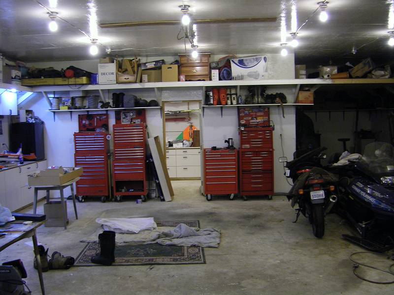

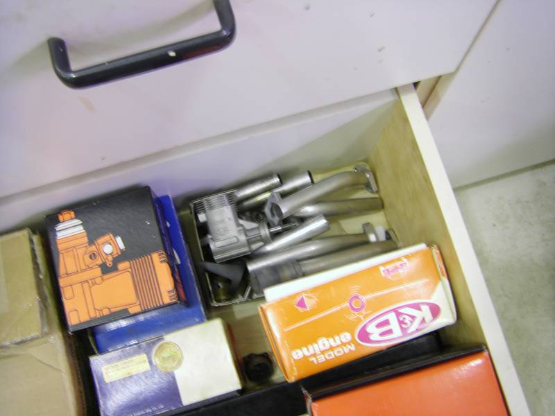

here are a few more pics. excuse the mess of my shop(coffee cups) ETC.

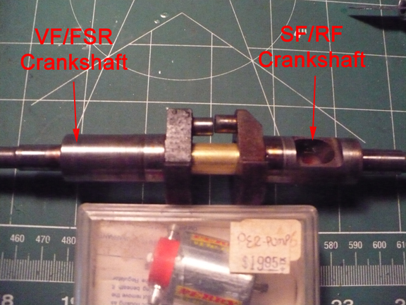

and once again ROGUEDOG is how shall i say, more right than me.i was at my shop and took the rf with the rfn piston fsr sleeve apart. i took out the 1/16 inch of shim i had under the lip of the sleeve. know the ports do line up perfect. the piston is still below the exhaust port at BDC BY SAY 30 TO 45 THOU. I LOOKED HI AND LOW AND FOUND 5 24 MM. HEAD GASKETS. AND THIS ALLOWS FOR THE PISTON NOT TO HIT THE HEAD.BUT I AM SURE I AM GOING TO HAVE PROBLEMS WITH TO MUCH COMPRESSION .I WILL HAVE TO PLAY WITH ADDITIONAL HEAD GASKETS I AM SURE. TO CURE THE EXHAUST PORT LIP PROBLEM I THINK MAYBE I WILL ANGLE THE LIP DOWN INSTEAD OF LOWERING THE PORT THE TOTAL 30 TO 45 THOU. OR MAYBE I AM WORRIED ABOUT NOTHING. WHAT DO U THINK
