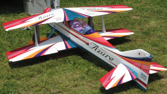

Default RE: One wing or two
Hi Guys,
Speaking of biplanes here`s the new Naruke Hobby ''Azure'' new toy for T.Onda to play with.
Only one word ''Immaculate'' comes to my mind simply amazing...!!!.
Specifically designed for the demanding Final and Unknown Patterns.
http://homepage3.nifty.com/naru/azura.htm
Regards.

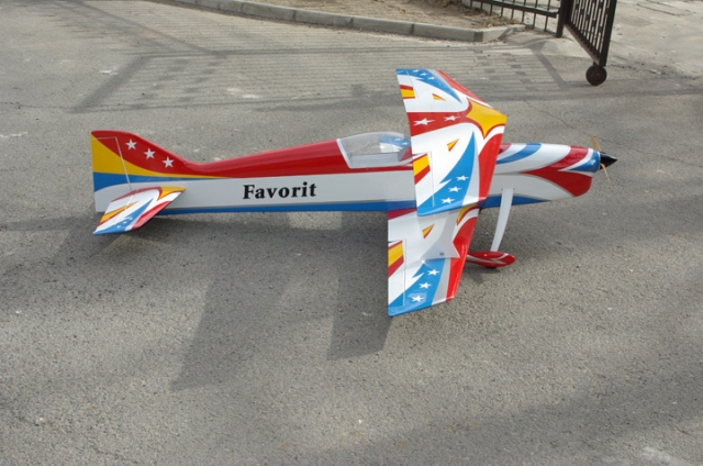

Hi Guys,
This other biplane looks really really nice,flown bya father and son team from Germany flying it with E-power..!!.
It would be nice to hear somefeedback on the flying characteristics of the Chinese designed and produced by Flight-8 "Favorit" biplane.
It looks to be designed for E-power and retails for $2120.
http://www.flight-8.com/F3a-382.html...juqj4qi4sf1jt3
Regards.

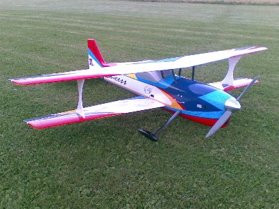

I'm sorry.. I did not build the plane myself.. A fellow F3A-pilot (and Norwegian F3A-team veteran), Kjell Tore Pettersen is the master behind my plane. He built the wings himself, as he thought the original were too heavy... He is now flying the Oxai Adventure (among other planes..).
If I don't remember wrongly, the weight with the Ys170 and standars NiCd 5Cell pack was 5007g... I've now changed to an A123 1100mAh battery, so the weight shoud be ok.
</p>
Bottom wing of my plane is 340 gramms without cowering and servos. It`s heavy?</p>
I will try to get some weights for you soon...
Please let me know if you need detail photos for your build...
Sorry for the slight off-topic post here.
Here are the weights of my Suxess (using my wifes' small kitchen weight):
-Bottom wing (all included): 577g
- Top wing (all included) : 637g
- Wing supports : 63g
- Belly pan :144g
- Fuse (all inclded) : 3560g
- Wing bolts (all 16 of them..) : 20g
All up weight : 5001g! (Gotta check that weight...)
Compared to my Oxalys, it's a heavy plane.. The total weight there is 4520g (Ys 160 w/Asano short pipe). (I'm usingan Ola Fremming modified wing of 964g. The original ZN Wing weighs 763g empty). Ola Fremming knows how to buildhis planeslight! - My Oxalys being bought from him last year and converted to YS Power..
