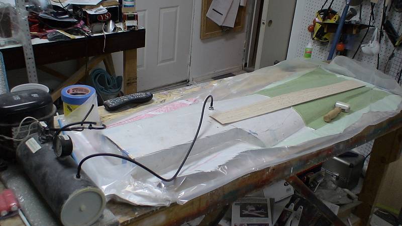

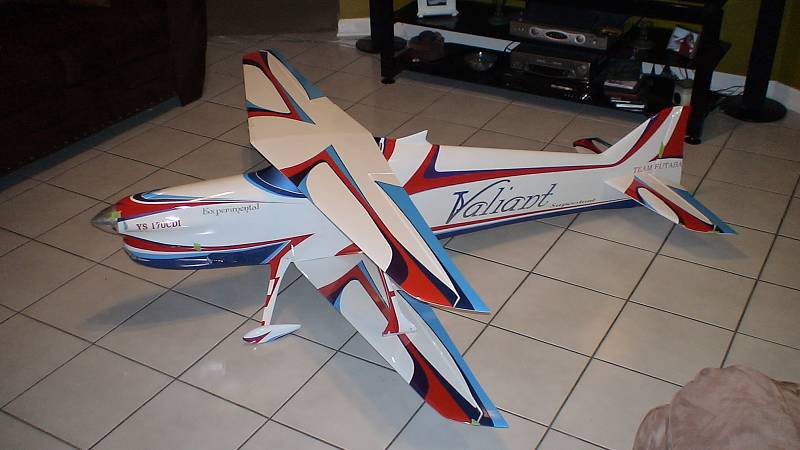

Here is My Proto" Super Stunt" I built last year to shake out the design being built for Oxia

Very nice design Bryan, thank you for shearing with us [sm=thumbs_up.gif]. Enjoy the pictures, I don´t think they lasts too much. (Just kidding, no ofence)

Very nice Bryan. Good luck and good flying with the model. A well designed bipe has definite advantages over monos in today's F3A schedules. I like the few features I see from the design point of view.
Curious, what prop are you using on the 170?

Matt,
I believe Bryan is running the 19X11. He and I had a long talk about props last month and he really liked that one...and I totally agree,

Arch is right I am using the 19-11 APC
this is a great prop for mid range and braking However, after watching Brett Wickizer fly with a 20-10 APC I might change my Mind.

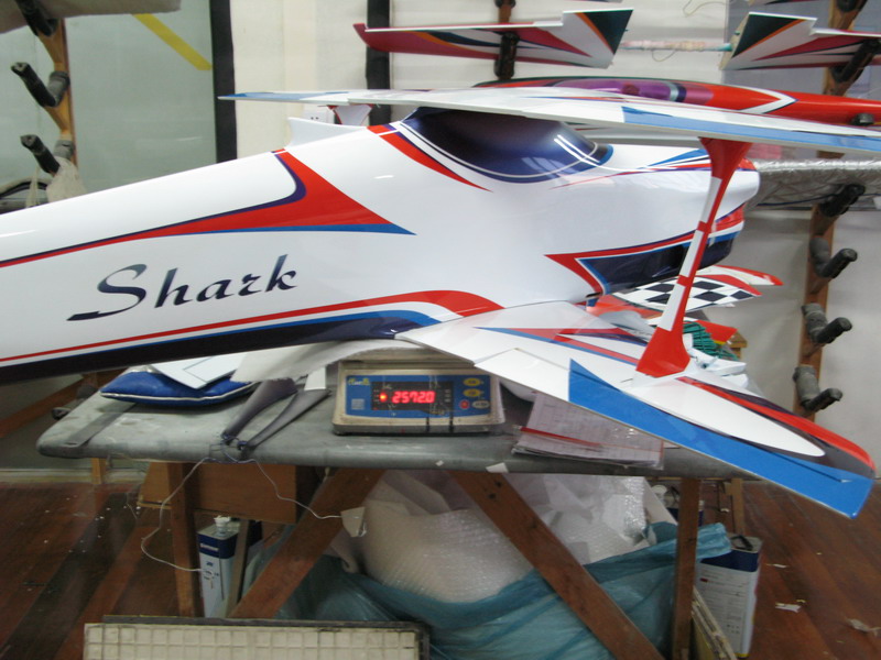

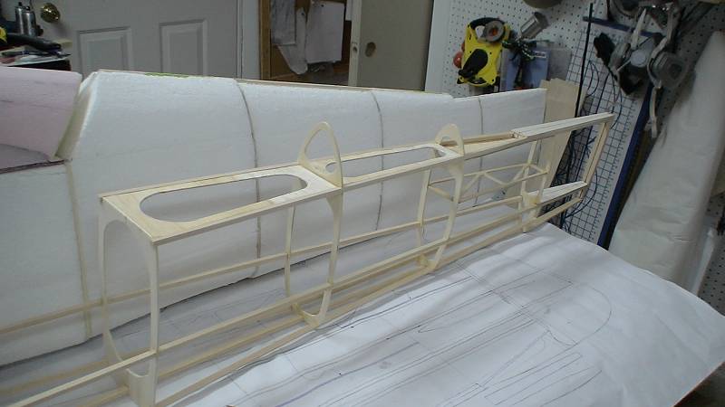

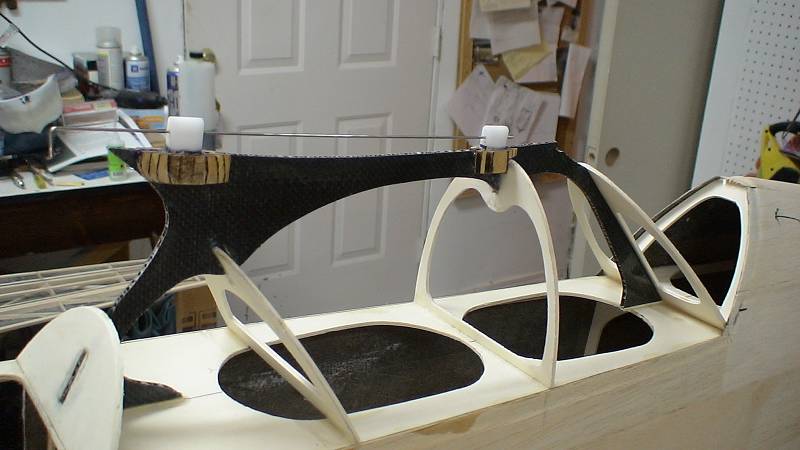

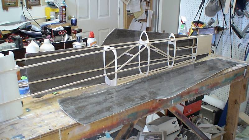

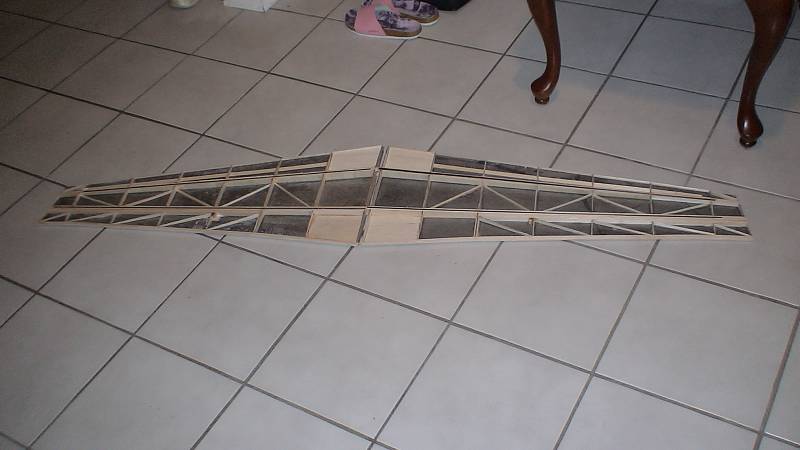

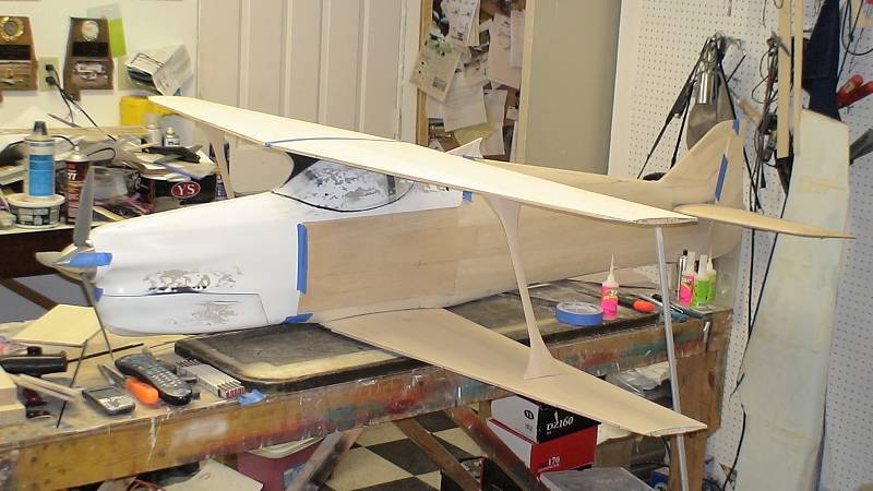

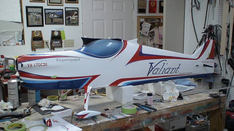

Hi Torben
It will be made glow and Elec.
The electric version will have a removable top hatch but not a removable chin
the glow will have a removable chin,
One the features of this airplane is the sharp crisp snaps its capable of,,, up ,down, Knife,,,, the inc. arrangements are different from any Bipe currently produced.
it also flys in the wind very solid and stable.

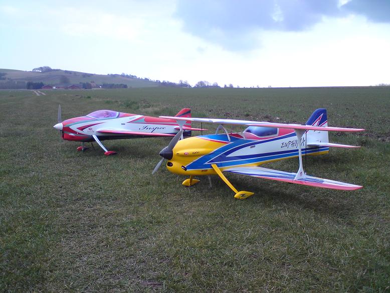

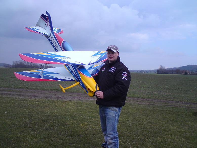

hi Bryan
yes , i have same felling about my Euphoria, the best plane, to Handel the wind, i have had,[]
i had a liking fuel line ,and the lower wing is damaged. the foam is gone, and paint too from inside
so no more flying with that!!

So, is the Shark & the Valiant the same plane?

Hi Adrian
Yes I decided to rename the Bipe after I painted and test flew it
and then, used that name on the Comp-Arf Mono instead .
The original name for the Mono was "Xiphos"But another company came out with a similar name and I didn`t want the Confusion between the two airplanes and MF.
"Shark" was obviously chosen for the fins on the bipe and the cool shape I used on the wings and stabs

Dean built at least 3 different versions ,,so he and I could prove the an/diheadral wings and make sure that tiny rudder was going to be enough. he didn`t beleive me LOL
after Dean plotted the 3-d Files for me, for the wings and some 12" close to scale side profiles
Mark Hunt transfered them into a cad file and had them laser cut for me
and also cut some foam wings so I could make the Molds for the Proto. <lost foam Method> revrese built
Both these guys are first rate friends and Masters in their own designing and building
It was great to be able to work with them I hope they earn some repect for the Effort
they sure earned Mine
Bryan

Awesome work Bryan. That is some of the most innovative building I've seen.
