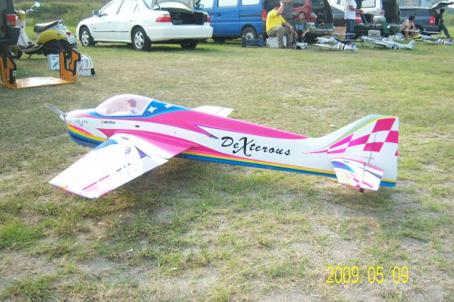

I use it for my Dexterous 170.It work fantasy,I think after use SAVOX Servo I will not use JR again!!
