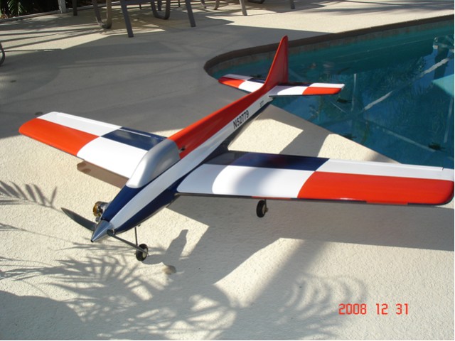

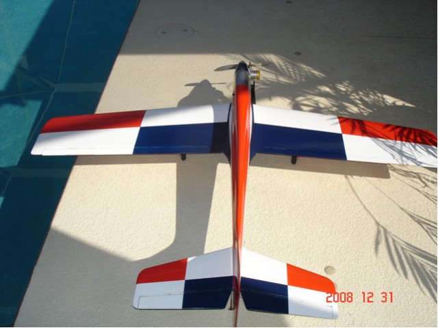

Yes. I am not an aeronautical engineer, but I once heard for every degree of swept wing, there was a certain degree of dihedral.
Vince V.

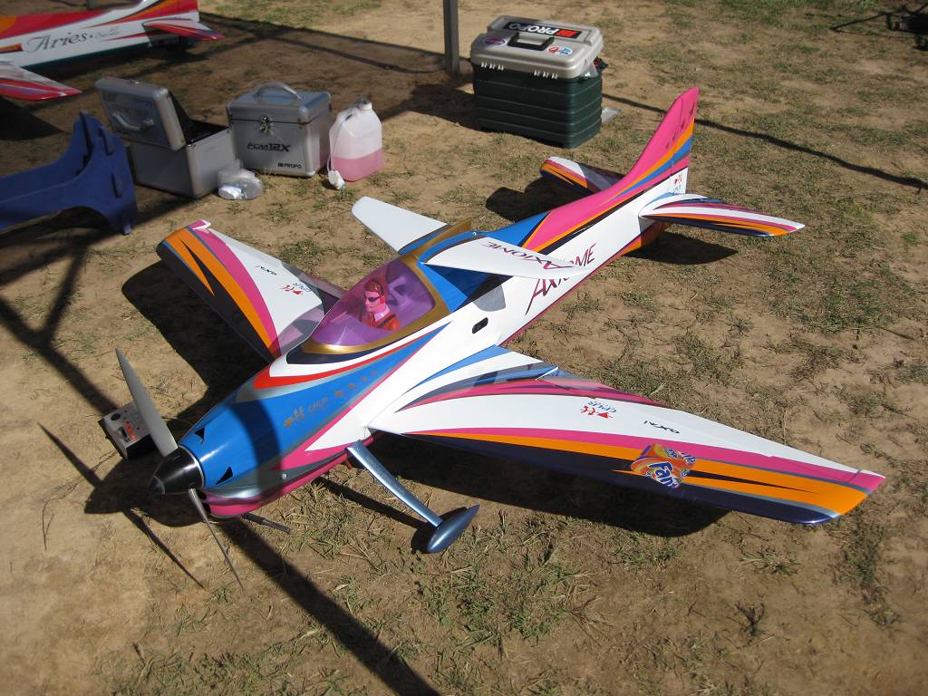

I think it's meant to be about planes like this Axiome and Seba's new Miss Wind Pro with swept wings.

Looks a bit dusty in that picture, Jason.

swept, tapered, what's the difference between the 2? Is my current build swept and tapered (even double tapered)? even the airfoil is tapered. i know the ailerons are tapered, they had to be hand sanded to fit the wing taper, not an easy task.
http://www.rcuniverse.com/forum/m_6819340/tm.htm
edit to comment that post #138 has a decent shot of the swept tapered wings.

Yes it is a lil Stephen.
Ryan, that was actually in Australia... similar though

ORIGINAL: JAS
YES . . recognised the special "drink can repair patch" . .
