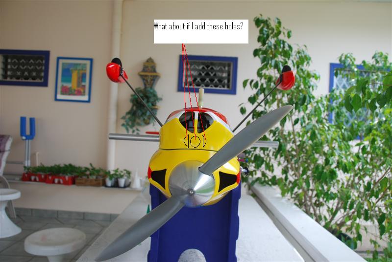

I did add 4 more holes in the bottom rear of the cowl near the pipe exit(see picture) and there was some improvment but it still gets too hot and shuts down during ground run. I was thinking of making some more small holes below the ones on the cowl that would expose the pump adjustment screw and two more like half moons on either side that would expose more of the cylinder cooling fins(see picture).

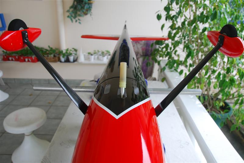

Burtone, any pictures of the Genesis with those extra holes/

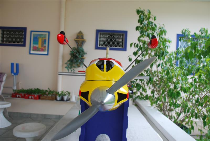

On my Angel Shadow I added a hole (2" diameter) in the middle of the bellypan to let air out near the front of the pipe. Also, guys around here were opening the fuselage part in front of the motor on their Genesis.

On the Valiant I found that I got better cooling by taping off the left (looking at nose) cheek and half of the bottom most opening. Motor ran much cooler. I still think a hole should be made in front of the cylinder.
