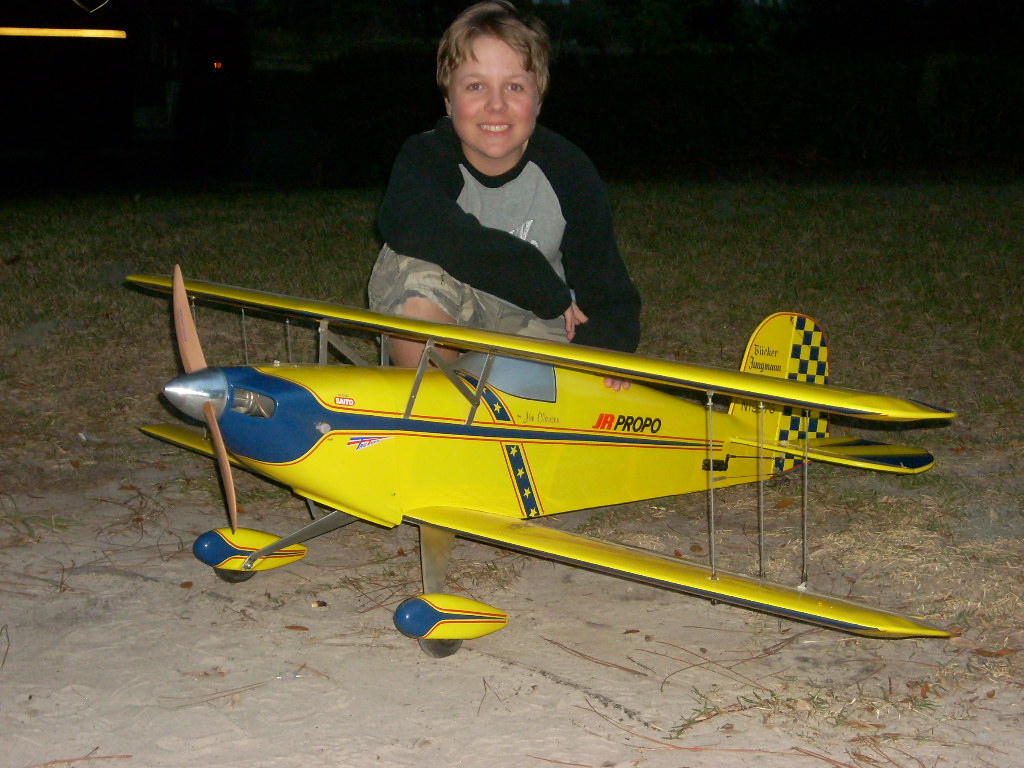

Heys Guys,
I recently aquired a Piedmont Focus with a Webra 1.45 2-stroke.
I am setting this aircraft up for my son to fly.
I do not have the recommended control throws for it.
I would really appreciate it if some one could help me out.
The Focus 2 would probally be similar.
I would really like for him to maiden it next weekend.
Thxs everyone for your help.

Ailerons 3/8"-1/2" up 3/8"-1/2" down
elevator 3/4" up 3/4" down
rudder 1 3/4"-2" left 1 3/4"-2" right
