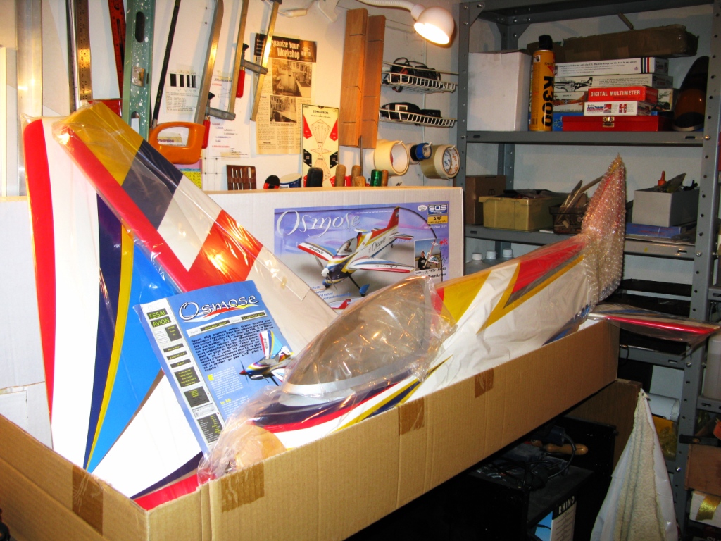

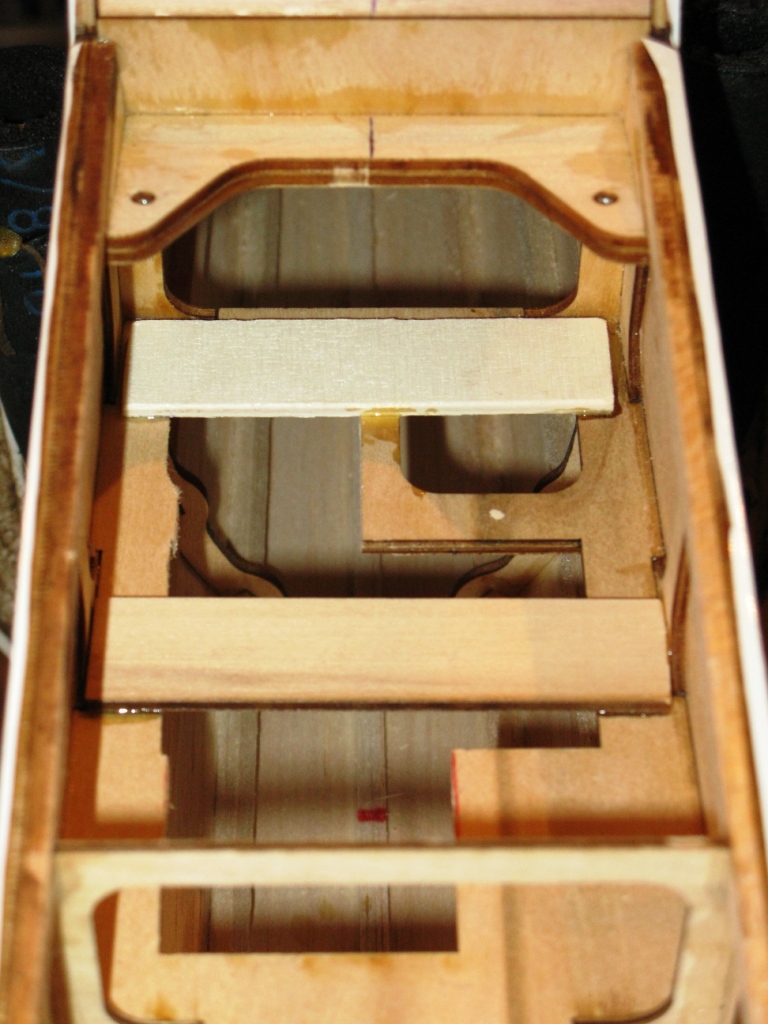

Hi everyone,
I am going to do a little thread on the Osmose70.
after crashing my Oxalys50 i ordered the Osmose70 (Esprit Model - USA) and its seems to be a better quality construction including the covering )
My final setup is as follows:
Engine: YS63S + Hatori muffler + Hyde mount
Servos: 4 CS140 digital from Hobbico, 1 CS35 MG Hobbico
Batt: Team Orion 1600 mHa
Prop: APC 13x6
all the setup in this plane were validated in my RIP oxalys...
enjoy the pictures

Old 12-14-2009 | 05:56 PM
stmdk's Avatar
Joined: Oct 2007
Posts: 69
From: jerusalem, ISRAEL
Default RE: Kyosho Osmose70 Build Thread

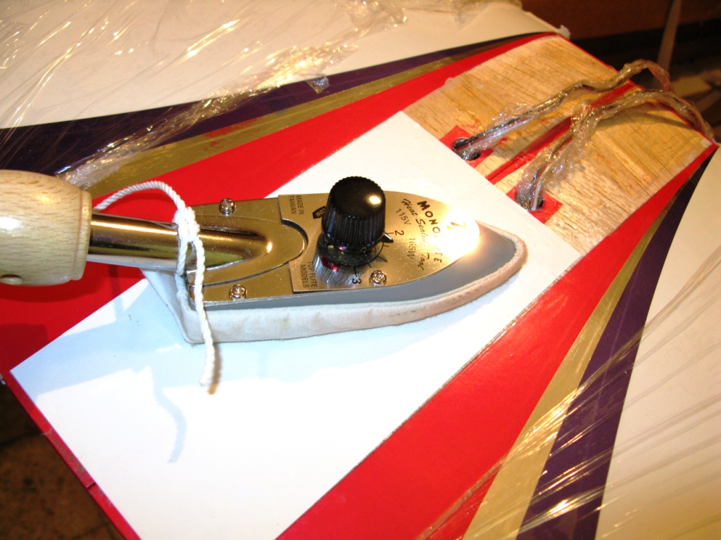

finishing the wing with some fiberglass:

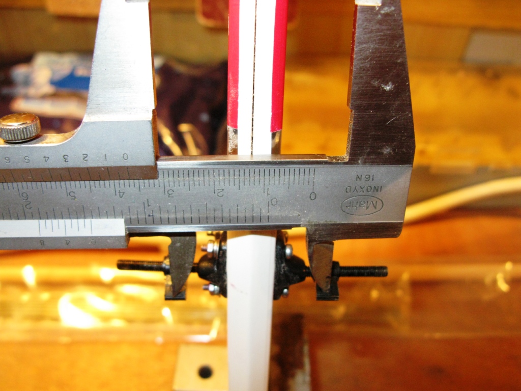

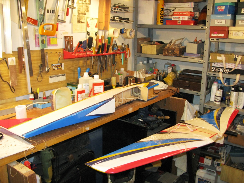

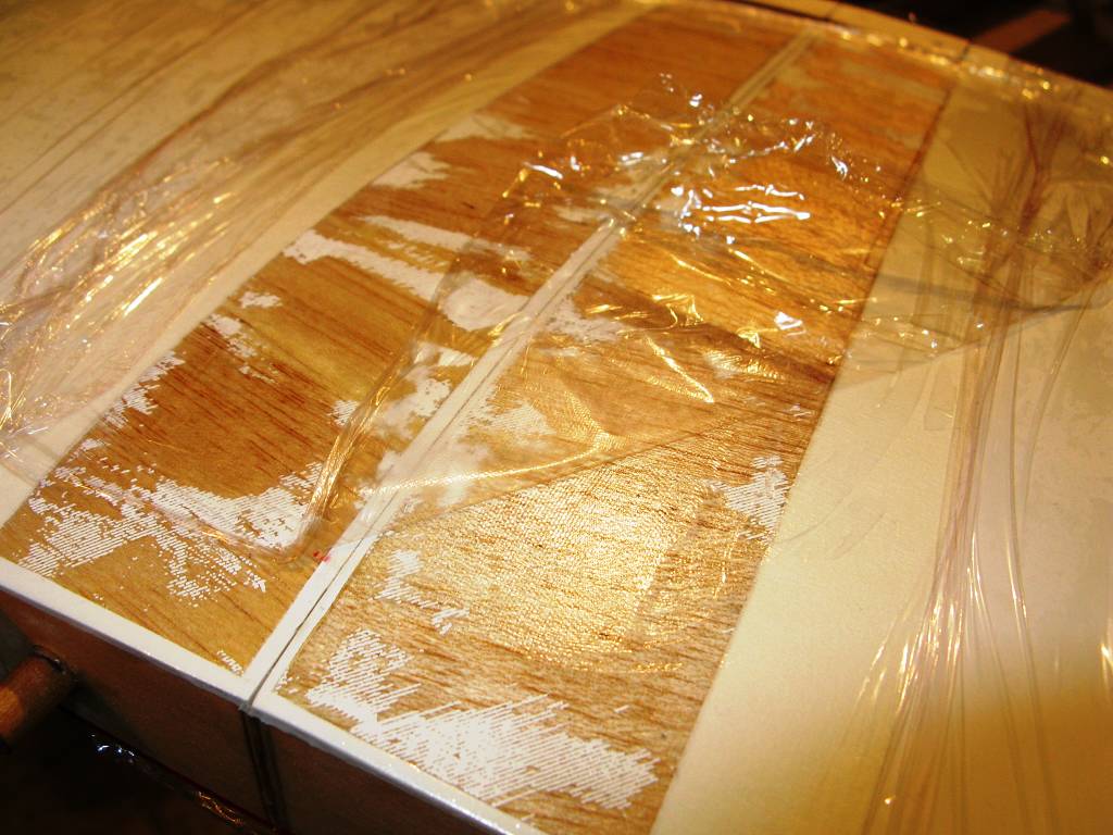

gluing the bottom of the wing.
i will make all the commands at the end of the building.

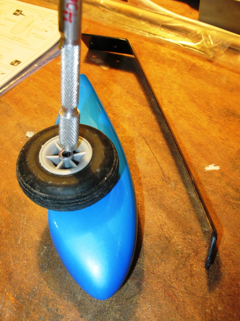

this is the gear setup, i changed the landing gear to a carbone one from www.hobbyking.com.
its a strong one and beautiful

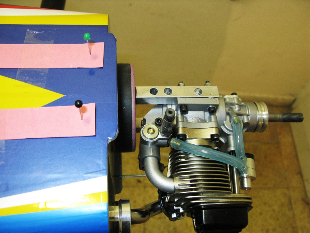

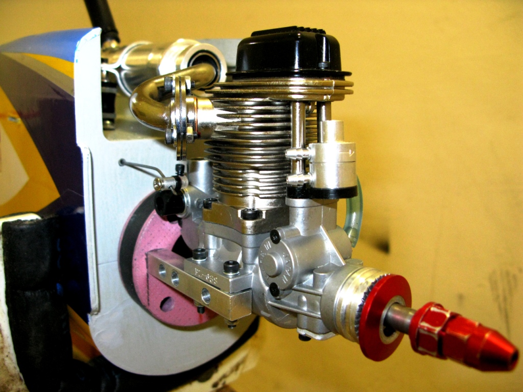

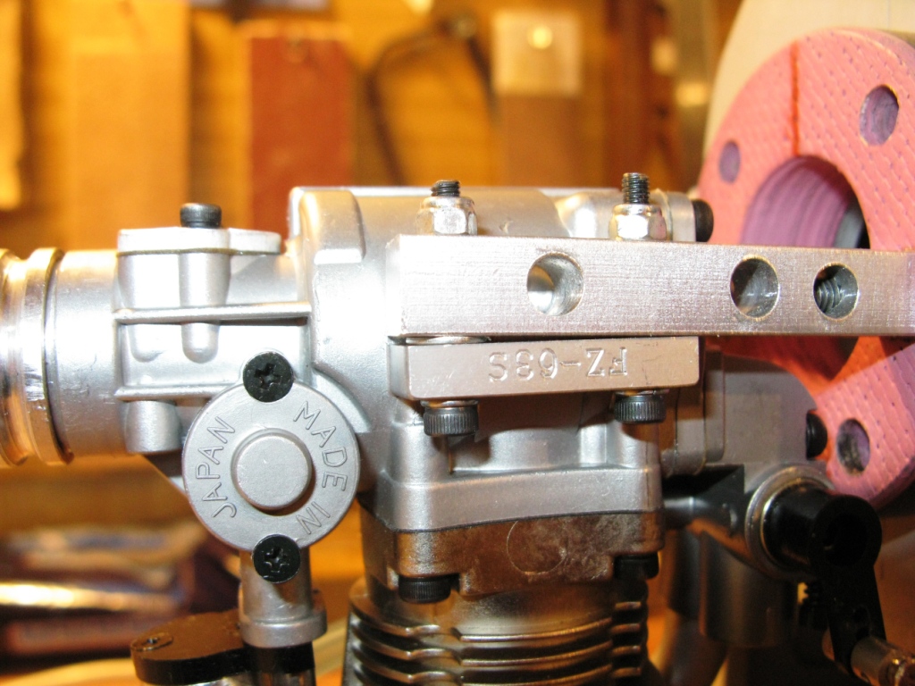

this is the engine installation:
i put 2 layers of Primer and 2 layer of cristal epoxy (firewall and the inside fuse) for protecting against the fuel.
i monted the Hyde mount for the YS63S and the Hatori header and pipe.

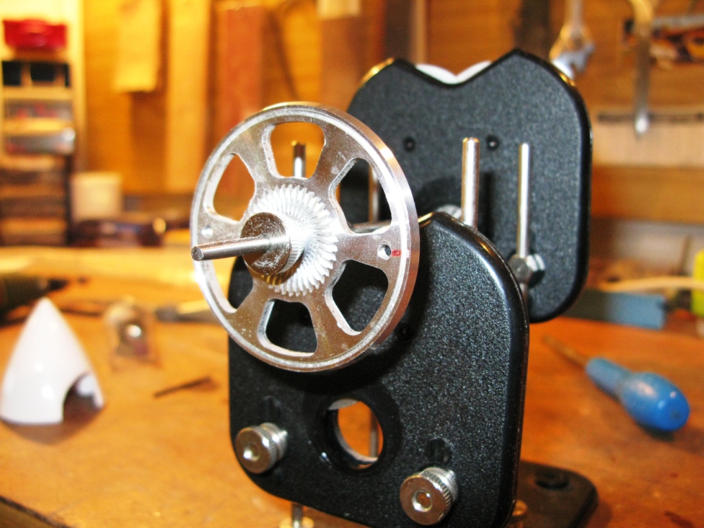

Old 01-11-2010 | 08:33 PM
stmdk's Avatar
Joined: Oct 2007
Posts: 69

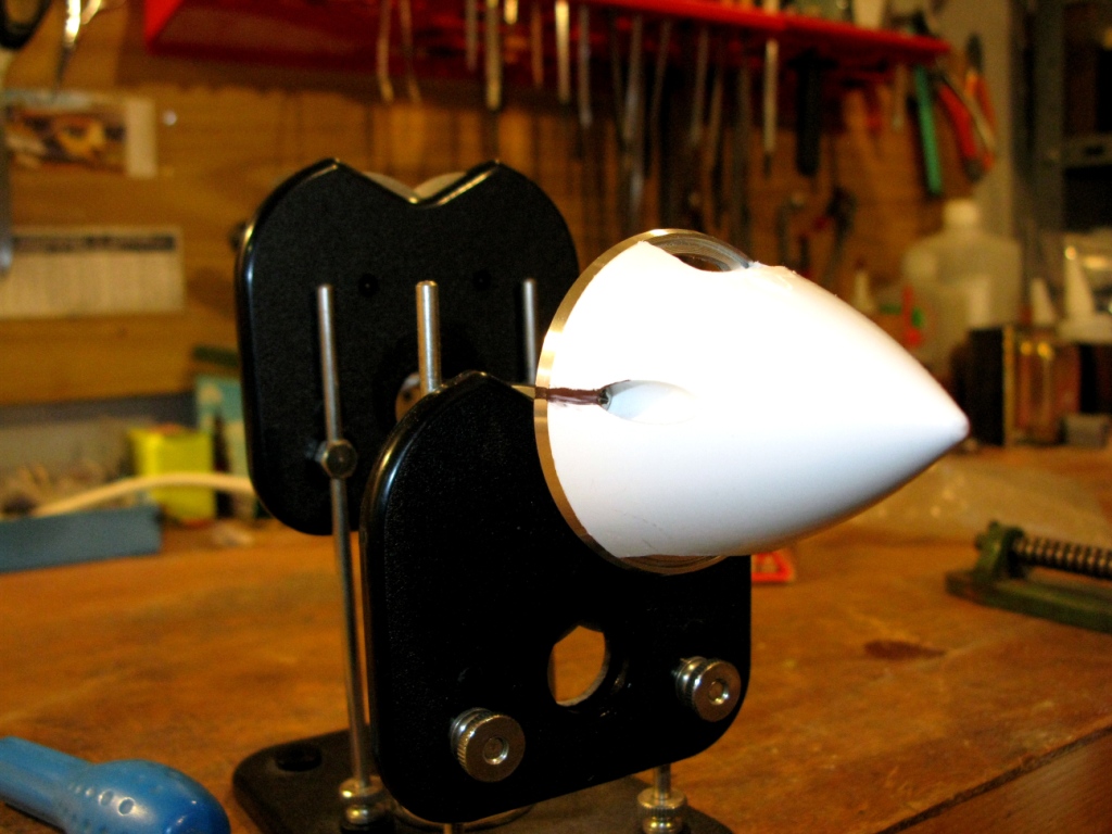

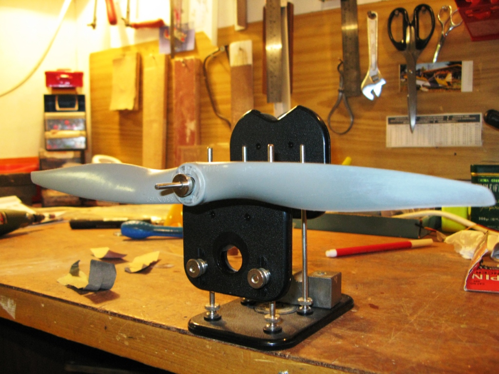

this is the cowl installation and the prop+spiner balancing, a very crucial step !!

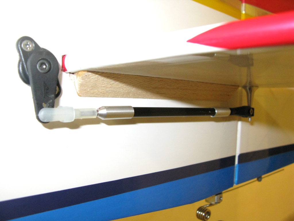

Old 07-02-2010 | 08:04 AM
stmdk's Avatar
Joined: Oct 2007
Posts: 69

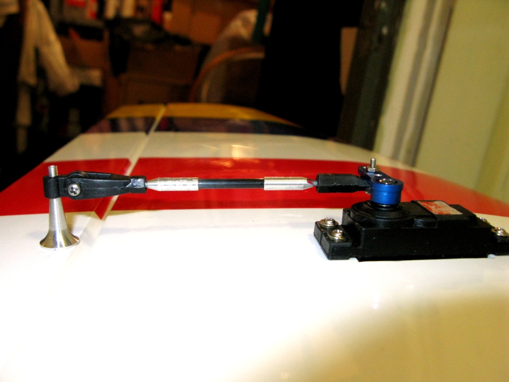

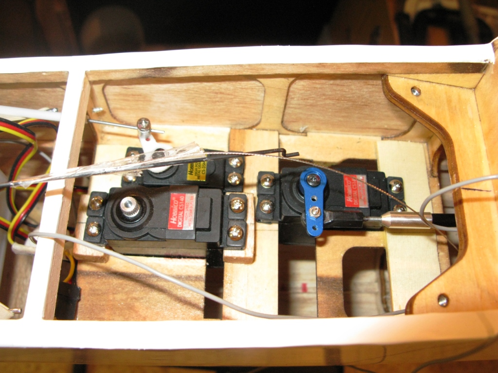

the rudder instalation:

the servos installation:
