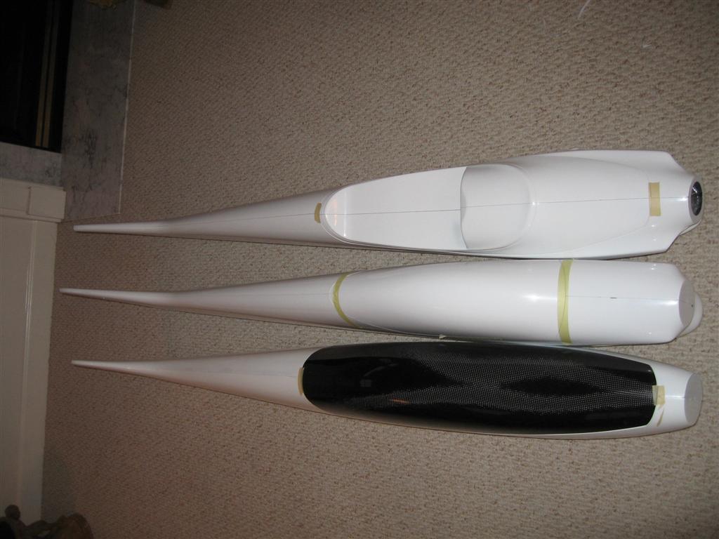

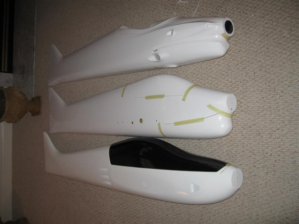

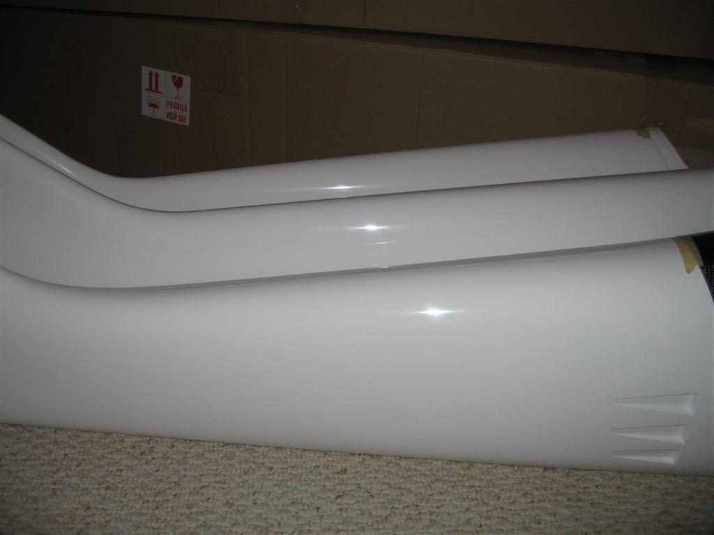

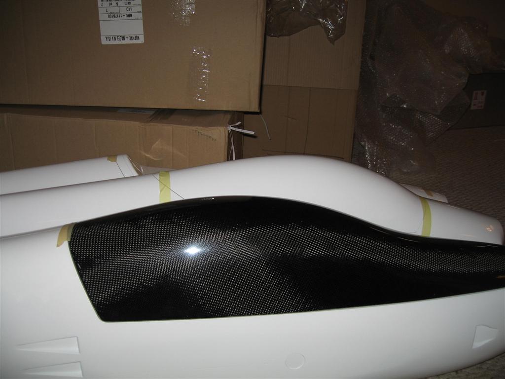

I did not want to mess up any of the nice build threads on the Xigris but wanted to post info on the Xigris and answer some questions that were pm'd to me.
The first shipment to the US was picked up on 12/17 and are sold out. Someone asked for a comparison between the Delro E-Motion and Xigris and Axial fuses so here is it. E-Motion on the bottom, Xigris in the center, and Axial on top.
Also, here are the C1 (top) and C2 wings butt to butt for comparison.

Got a question Chris... It appears the holes for the wing and stab have been cut out already, is that how they come? Isaacs on the other thread had tape marking the locations of the holes on his C2. On another thread I thought somebody said they had to figure the location of the holes and cut them themselves. Just curious/confused...
Guess I'll know next week for sure won't I?

The fuses now come with the holes cut out. The wings also have the root ribs installed. This is different from some of the earlier kits.
The fuses weigh 28.5oz with the canopy and chin cowl included. Wing panels on the C1 were around 8.8oz and needed aileron capping and leading edges and tips installed. I think Najary's thread has more complete Xigris weights. I only took a couple of weight measurements as I needed these inspected and back out the door to arrive before Christmas.

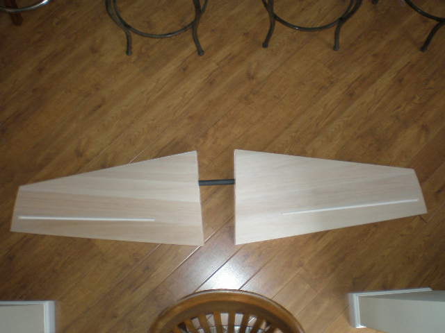

As promised here's my C1 wings with the wing tube orienting them as though they were on the plane
to show the planform.
As far as wing area I "swagged" what would be added to the wing dimensions when the wing tip and leading
and trailing edges are included. I made no attempt to include any effective fuse area.
I came up with 451 square inches per panel.
The weight was 8.5 oz each panel.
I am very impressed with the quality...especially the fuselage. In my brief pattern career this time
around it's the nicest pattern plane I have personally seen.
Now all I have to do is build it!
JLK

Looks like the perfect planform...no sweep!!
Colin.

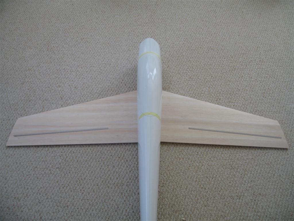

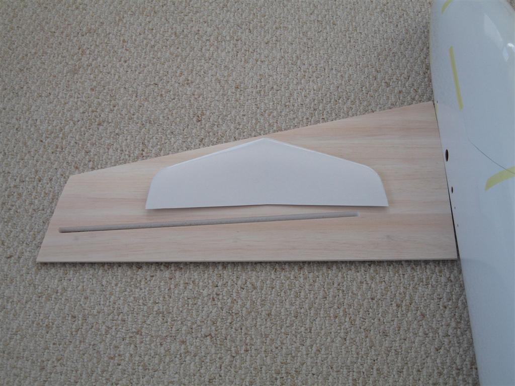

Colin, here are the C2 wings up against the fuse for proper perspective.

Ahhh...thanks Chris. And the wing area?
Did ZN reduce the area based on the T-can area as CPLR did...or is it the same as the C1?
Colin.

The C2 wings are definitely smaller in area. My calculation with the tip blocks and l.e. and t.e attached is about 418sq inches per panel. The T-Can is quite large and I calculate about 90sq in for T-Can.

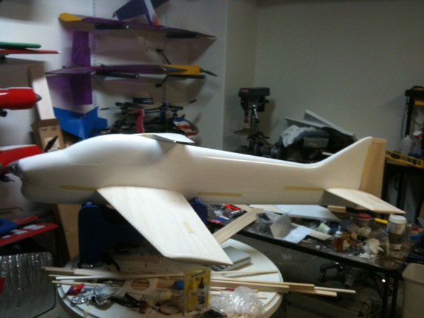

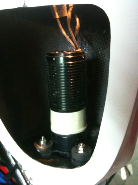

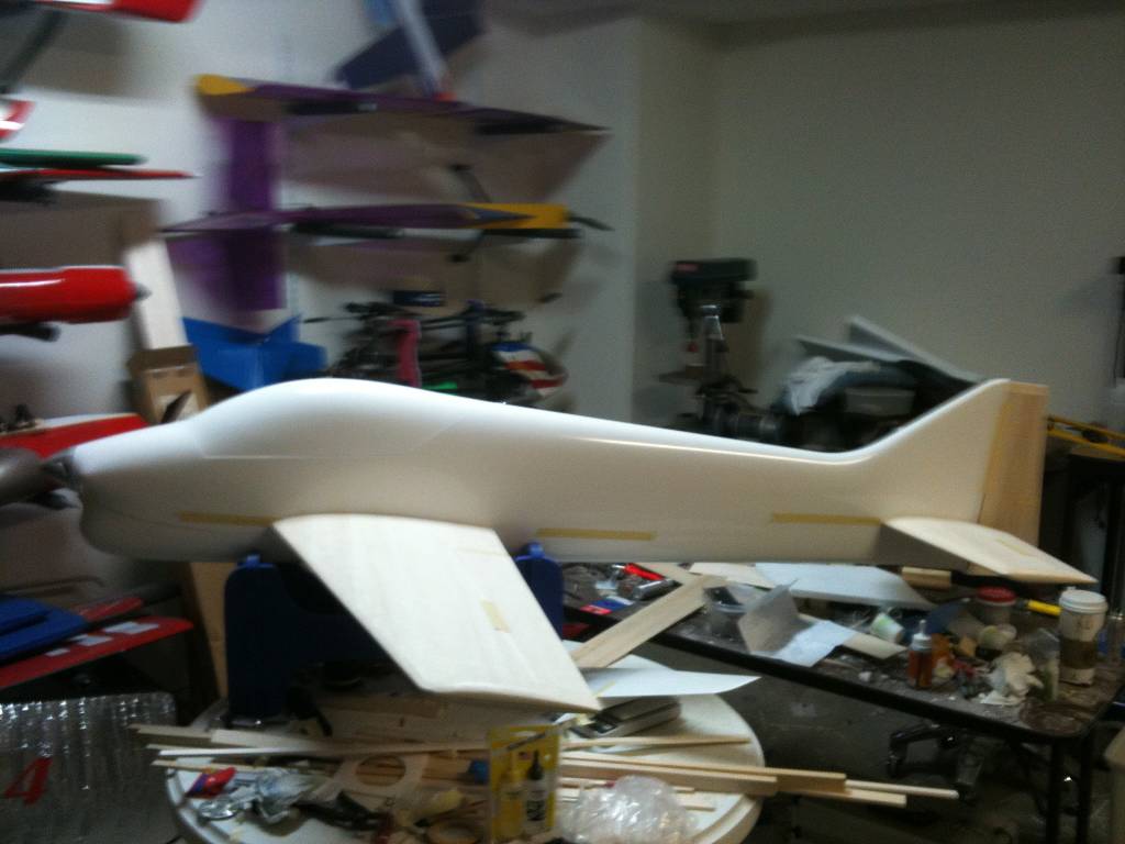

Just an update on my Xigris C2. There are a number of build threads floating around so I won't go into detail, those guys do a MUCH better job than I could for sure! The plane is coming along nicely, I have about two weeks into the project. Wings are done except for beveling and finish sanding, as are the stabs and rudder. Fuse has the wings and stab aligned and installed, the motor is partially installed.
I am using the Neu F3A with a Budd soft mount. Because of the configuration of the the motor mounting, I had to fabricate a firewall for the mount to attach to about 7/8" behind the nose ring. I was annoyed to discover this, but i really didn't take to long to come up with. The motor is sitting in the nose without glue, I still have a few things to figure out.
Not sure how the weight is going to go, I am trying to build it very light. The wings finished each way 9.6 ounces less covering, servo, and linkage.
Below are pictures with the plane and the finished surfaces installed... the T-can is taped in place. The video posted by JP will help, but I'm not looking forward to the installation of the T-can at all. I provided pics of the plane with and without the T-can in place... I actually favor the picture without it! Or maybe that's laziness? lol
The fit and finish of the canopy and chin cowls are very impressive. The quality of the wood is mostly good, with only one or two balsa pieces being inconsistant. I have always wanted to build a ZN Line kit and this one has not disappointed me. I had hope dto have it ready for finishing at the end of Feb. It's looking like I'll beat that.
Tom M
