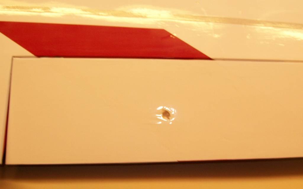

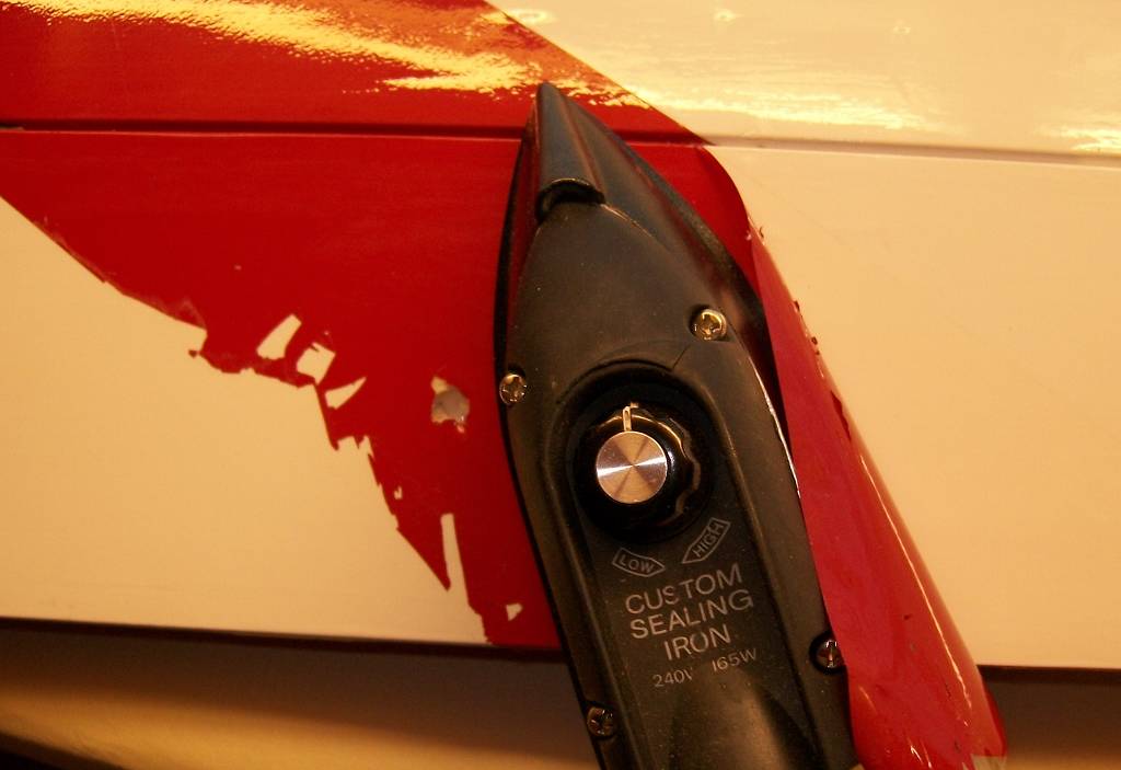

Next up was to fill out a hole in the aieleron. This area has a red graphic stuck on top of the white base covering so I decided to remove the red graphic and fill out the surface below then add a new graphic when completed. Now, this sounds easy but if you've ever tried to get a sticky back piece of "solartrim" off a surface you'll be familiar with the problems that brings, namely the clear parting company with the base colour and also tearing at the edges making removing all the little pieces a real b*tch of a job to get off [:@] well not anymore. Take your covering iron set to a med/low heat and rub it over the area you want to remove, then gently peel up an edge with a scalpal blade, just enough to grab a hold of it and then re-apply the iron behind where your pulling and gently move the iron back as you pull the trim off, it comes off like a wet water slide! Heres some pics on the process:

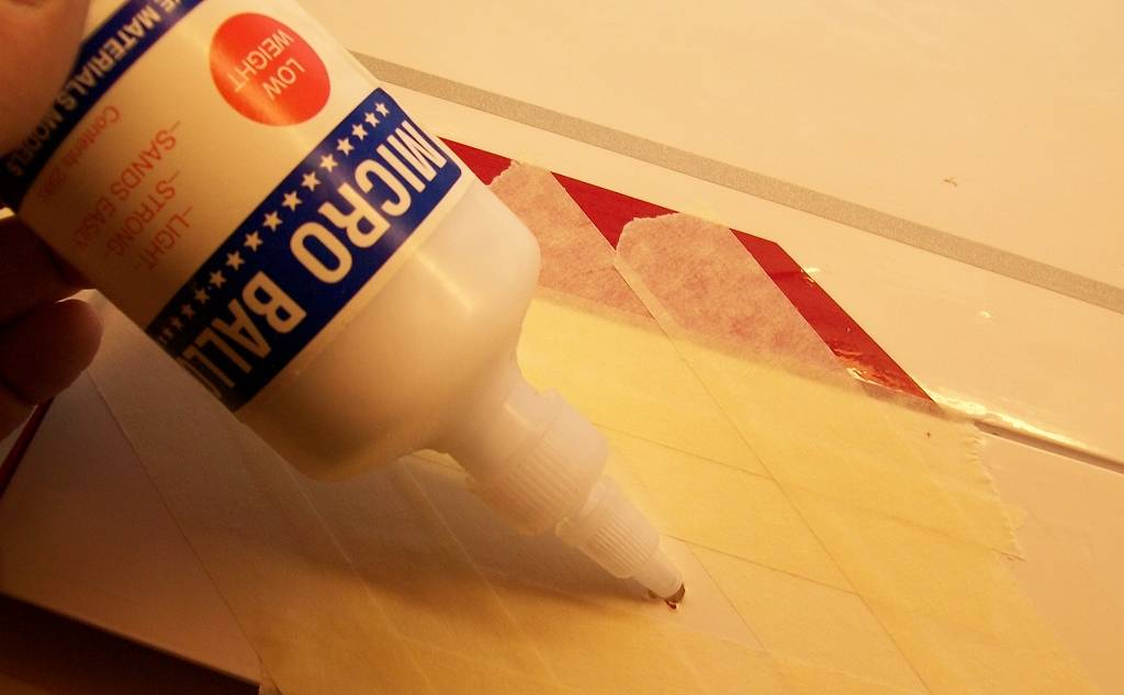

So, now we have the damged area ready to repair, cosmetic for this one as the damage was just a little hole. I took some masking tape and masked around the hole, then I filled the hole with some micro balloons and finally dripped some foamsafe CA in to the balloons. Give this a light misting of kicker and then sand it back. This is just to harden up the area ready for some fine surface filler. I then filled this out and sanded back then topped it off with a little P38 just to get a really hard but polished surface for the decal trim to stick to.

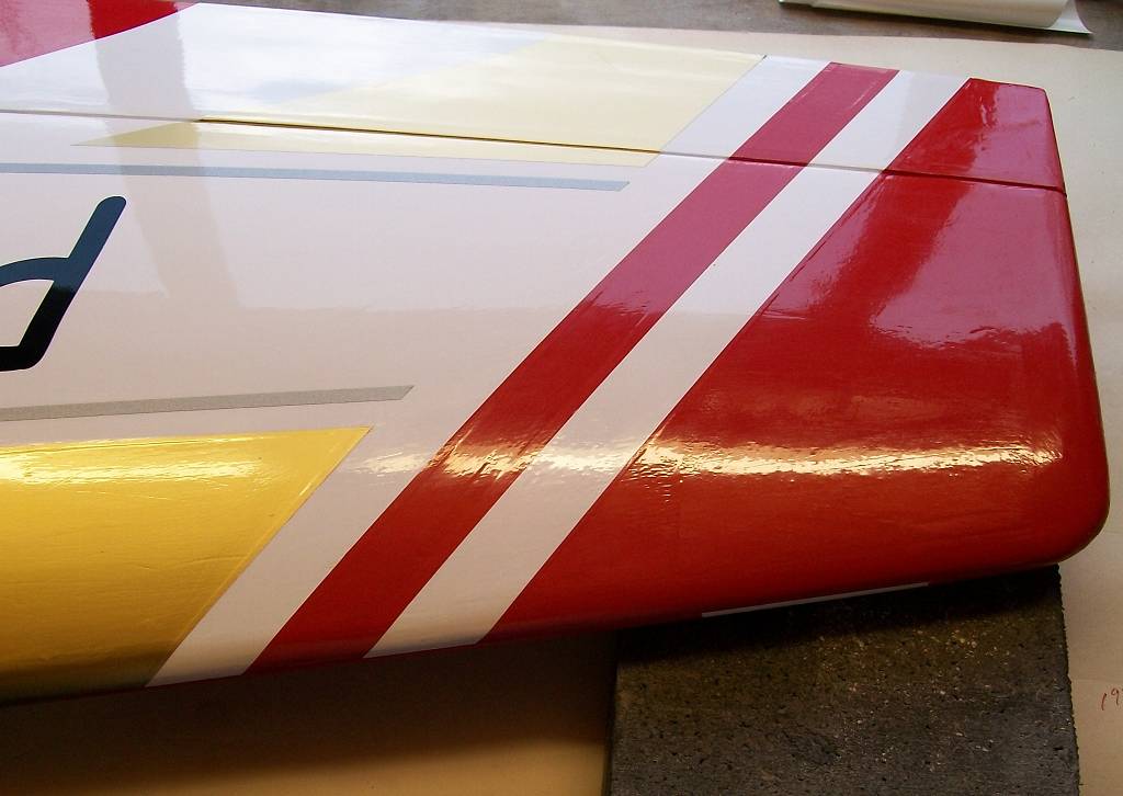

and finally a few pics of the finished project. Once again thanks for all the kind words and interest here and I'm glad it has helped some of you guy's for the future, happy flying!
