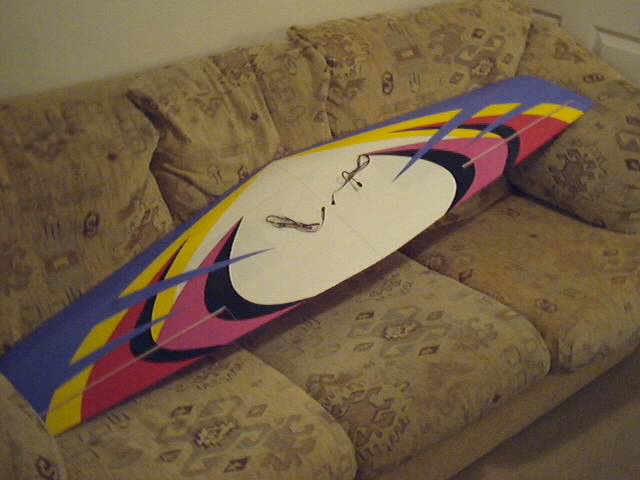

Default Wing
Wingspan = 1650mm
as you can see quite good wing sizing, the kit is built lightly but strongly also...

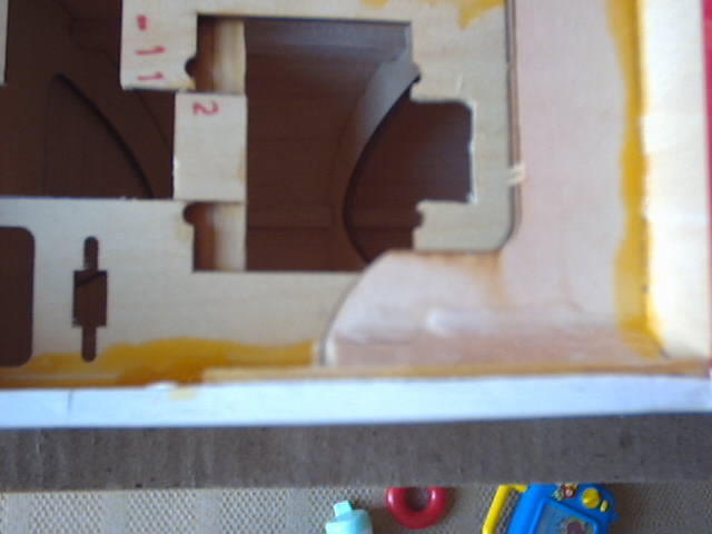

Default Rudder...
Everyone has been telling me 'get a heavy duty servo for the rudder'.. Anyway, I had a load of 3003's (3kg) hanging about looking for a home so I thought I'd do a slight customisation and run 2 in series... hopefully should be double the torque or thereabouts.... Am also going to be running a 6v system so with luck I should be at about 7kg for the rudder. When you think about the size of the fin area, the weight of the plane and flying this thing at knife edge I would say that should be about right... comments?
here's some (although extreme bad quality) pics of the mod in progress...

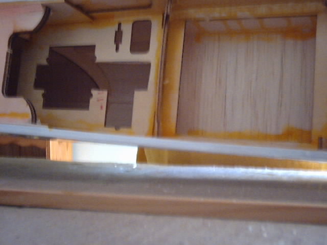

Default reinforcing for the mount
next to come... fitting the servos and making up the connectors, does anyone know how much torque a standard control horn will take?

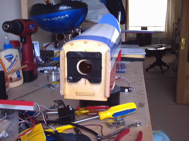

Default Engine Mount
On the bench with the engine mount back plate fitted....
I like this mount as you can mount it centrally then slide the engine horizontally in adjustment by about 3 or 4 mm. This may sound weak but it comes with quite oversize bolts (hex drive) and decent blind nuts so take it from me it's not coming undone in a rush.... a bit of locktight also helps... You can see I've got a cutout at the bottom of the mount. This is to ensure that the engine can be mounted as far back as possible and is there to give some space for a couple of bolts that protrude from the carb. I've removed the choke mechanism, it saved me 5mm.
The logic in doing this is due to the length difference of the 120 over a standard 90. I have heard that the YS 90 is a long motor anyway with the pump and all so by doing this mod hopefully it will keep the latitudinal response and cg mostly where the factory says.

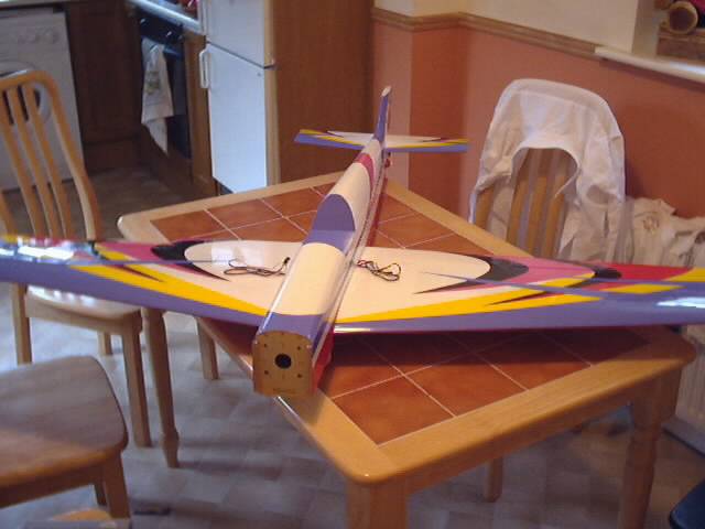

Default wingon
First test fit with the wing on and horizontal stab in. Looking good! cables are coming out under the fues, I didn't run them up through the outside ;-)

From: Dublin, IRELAND
Default engineon
Engine installed in place.... check out how close the mixture screw is to the firewall... phew.. don't want to bump that guy or the mix goes haywire... luckily have found that the engine doesn't torque enough to adjust it for me... :-)
Not sure if you can see the slide holes for the mount. It's an Anderson brand mount if anyone is interested.... nice and solid
