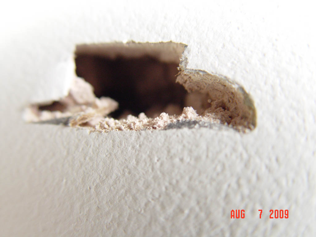

Adding to the heat is the lower pump pushrod in contact with the cam lobe and the bottom of the pump piston.
Also, the friction of the piston in the pump housing is causing more heat....and in my case, this piston must have 'cocked' slightly....digging into the housing wall and forming a huge ledge. Normally, this piston can be easily removed but in MY pump it could not be removed due to this ledge.
This problem showed up as a uncontrollable sudden huge lean condition at WOT causing the TT double jam nuts and prop to blow off the shaft.
The fuel was CP 30%, prop was APC 19x11. The engine had at least a season of perfect operation on glow. On inspection I didnt notice any undue erosion of the valve seats.
The engine is a conversion from glow to CDI and has the low oil crank and lifters as well....even though it dosent need them.
Attached is a picture of the prop nut and washer which went through the garage wall after hit by the prop....I havent found the jam nut....it's probably still sailing along somewhere. I aim the test stand somewhere else now!
All test runs were on the PSP test stand which withstood all sudden stops from 7300 rpm......unlike the nose of an airplane.
YS Parts and Service replaced the pump.....thanks a lot Richard.

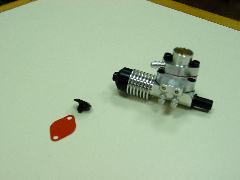

Hi
I got the 175 modified pump. See the pictures.
As you can see it is the entire assembly including the push road housing which is part of the modifications. I cannot add a scholar explanations like others but just god-feeling I had from day one that the push road housing is part of the problem. Also interesting to see that the regulator diaphragm is made of different material and more important its limiter is now a separate part and its all made of hard plastic..
I will test it in next few days. Temperature here about 35C (95F) in the shade so we shell see!
Regards
Amram

Hi Amram
I like what I see on the new pump. it has isolated and reduced the heat transfer from the case to the pump housing. What is not apparent is what they have done to isolate the heat from the "plunger" via both push rods on the intake side. It is my understanding that the plunger seal material[not sure what that is as I have never seen it] has been changed. It is my hope that the plunger will become a user accesed part for future mtc. & inspection! Looks like the new diaphram is made of a high temperature material to reduce the effect of heat deformity which was very apparent in the old material. The sealing valve appears to be non metalic and a seperate piece
Dick
Dick
