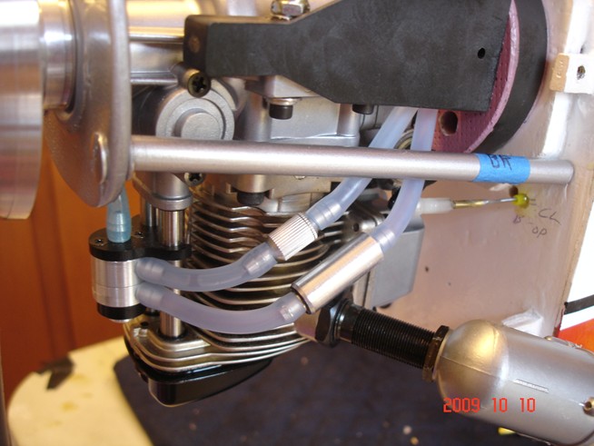

Central just got off the phone with YS Japan, November or December for the new YS115. That is what they said today. I am using the last production YS110 in a Focus Sport. I have another one on the bench, was hoping to put the new YS115 on the front. Looks like it may be a while, and who know's if Nov. Dec. will be the date.
I am not an expert here, and realize the advantage's of YS power. I am now considering the OS 110 or 120 pumped. Opinion's appreciated.

YS115
Displacement 18.73cc
Bore 30.4mm
Stroke 25.8mm
Weight 730g
OS 120 Pumper: - $465
Bore: 30.4mm (1.20")
Weight-With Muffler: 35.3oz (1000g)
OS110 pumper - $480
Bore: 1.20" (30.4mm)
Stroke: 0.98" (24.8mm)
Weight: 21.5oz (610g)
Muffler Weight: 2.5oz (72g)
Tuff choice. The os110 weighs less than the YS115. The os120 swing the same prop as the YS110. I think the os120 would be too heavy. I would check the Focus Sport thread to see if anyone is using an OS120 or OS110. There is only a $15 difference in price.

I happen to have run both the YS110S and the Saito 125 on that very same aircraft.
Each was run on 30% Wildcat, all synthetic. The mounting holes and mounting hole to back of prop dimension are identical. Only the servo/throttle linkage needs to change sides. With mufflers in place (stock) they are the same weight
Power = no contest. The YS was consistently 1000 rpm better on a 15x8 APC. The YS when flown a little will go to a 15x10. The Saito stops at the 15x8. The 15x10 is too much for it.
Tuning, well that is a no contest also.
The Saito sets up very quickly.
The YS is a royal PITA to set up but once you do get it right it has power to spare.
I had each engine mounted on the same Hyde mount with different cowls cut out to match the engine.
If you want to do the Focus Sport justice in the air, it has to be the YS.
I've since gone all electric but that was my last Glow set up.
BTW, I have not exaggerated one bit !
Not on the set up !! - and not on the power either.
Unless you want aerobatic limitations (the 125 will give unlimited vertical but does NOT begin to have the authority of the YS.) you should either find an available YS110S or simply wait for even more power and the 115.
Hopefully the new regulator set up on the 115 will make set up easier. Trust me, that will not be hard to do. []
I'd wait for the 115 (same mounting dimensions as the 110) but it is your choice.
