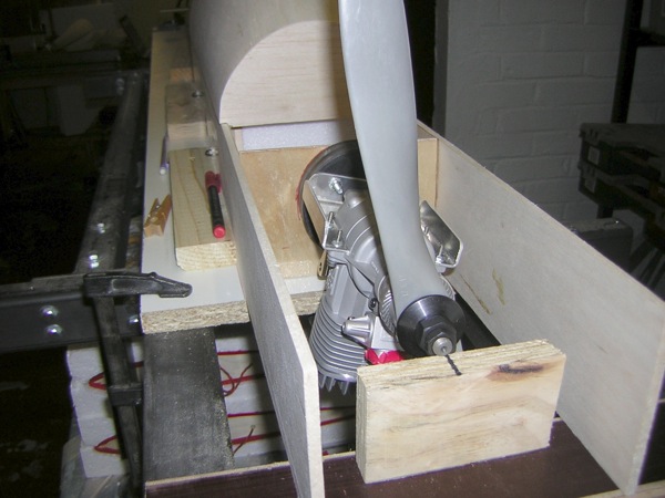

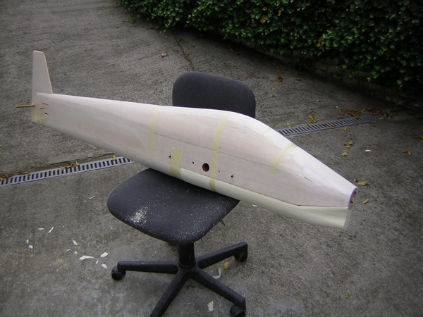

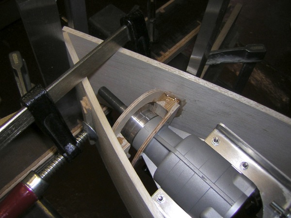

The construction of the fuse:
You will see one more time that I like the technique with Depron rib. When the rib have to be stronger, a plywood sheeting is used. All the glueing Depron/Balsa and Depron/plywood are made with PU glue. This glue is very interesting because it fill the holes and the slits.
For the construction of the fuse, I'm using a construction inspired by the insight from http://www.insightrc.com/. However, the shape of the fuse has been rounded.

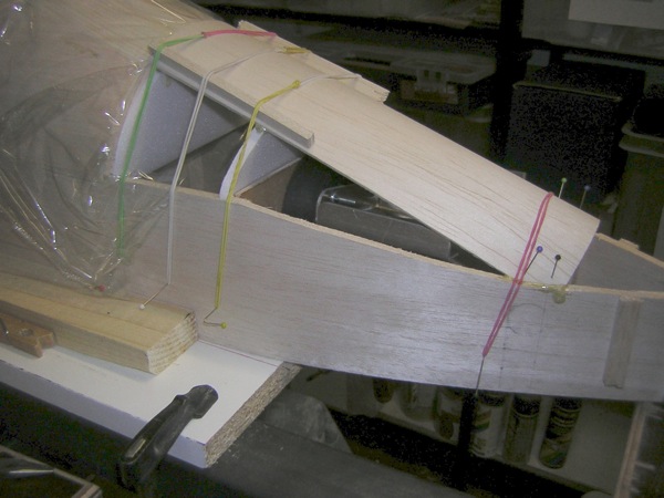

Some pictures of the rest of the construction:

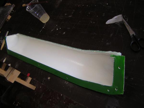

geoffroyBelgium 09-29-2009 10:47 AM
RE: My first 2X2 pattern plane construction
The plane is almost finish. I have just to mold the bottom part of the fuse.
http://www.lumay.be/imagesForums/mul...mostFinish.jpg
The master core is made with extruded polystyrene foam. The foam can be shaped with a hot wire, a knife or with sandpaper. To obtain a strong surface, the master is covered with a 80g glass fabric and Epoxy. The master is finished with a two components polyester painting.
The master is positioned on a support to make the first half of the mold:
http://www.lumay.be/imagesForums/mul...oulage0000.jpg
The master is covered with 3 layers of polished wax and finally one layer of PVA. After that, a special gelcoat for mold is applied generously with a brush.
http://www.lumay.be/imagesForums/mul...oulage0002.jpg
1 layer of mat 225g with polyester:
http://www.lumay.be/imagesForums/mul...oulage0003.jpg
After 3 layers of mat 300g, the first half is ready. Now the second half:
http://www.lumay.be/imagesForums/mul...oulage0004.jpg
http://www.lumay.be/imagesForums/mul...oulage0005.jpg
The mold is finished.
http://www.lumay.be/imagesForums/mul...oulage0006.jpg
http://www.lumay.be/imagesForums/mul...oulage0007.jpg
On each half, a layer of gelcoat is applied with a brush. A spray gun will give a better results... 2 layer of 80g glass fabric are applied on each part of the mould with Epoxy. When the Epoxy is a little bit cured, I cut the surplus of fabric along the junction. After that, the two parts of the mold are fixed together and a last layer of 80g fabric is applied.
http://www.lumay.be/imagesForums/mul...oulage0008.jpg
http://www.lumay.be/imagesForums/mul...oulage0009.jpg

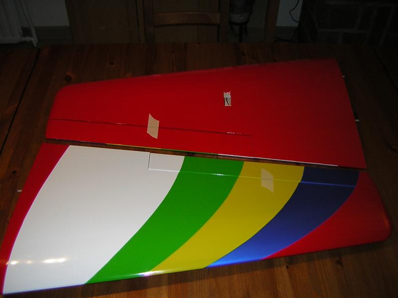

geoffroyBelgium 05-03-2010 02:39 PM
Hello,
After one year of construction, the GRAVITON is now finished.
