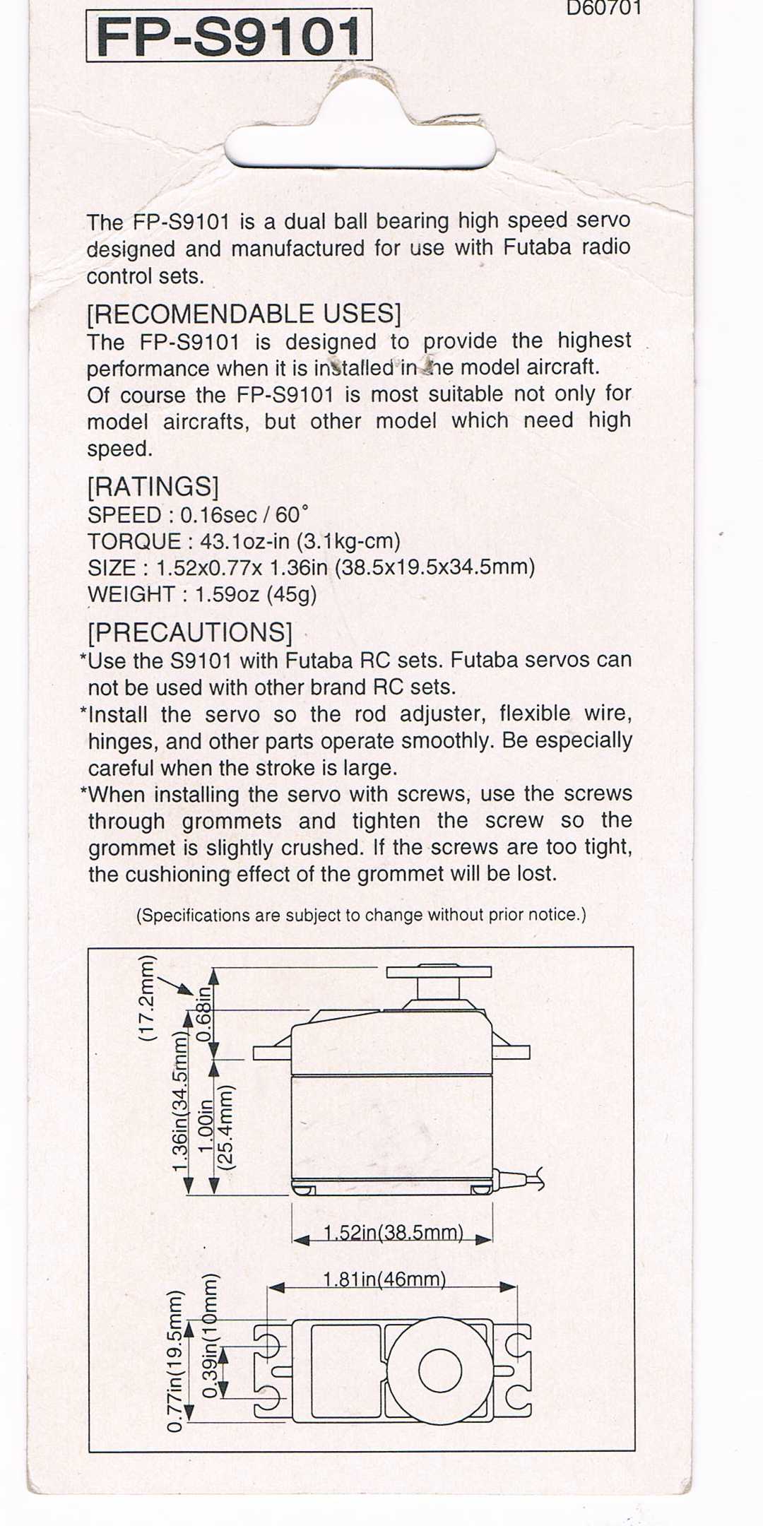

Jolly, The S9101s are rated for 4.8 volts ONLY. Anything higher will damage them. Dan.

I challenge this statement. Do you have that in writing from an official spec from Futaba?

Thank you. It didn't say anything about damaging them at 6v.

And the ServoDatabase has torque and Speed ratings listed for 6.0 volt operation!

The S30, S130, S5101 and S9101 are all good servos and share the same case. They have been around since the .60 engine size days and have changed electronically over time but they are all the same physically. That is why the have had such a long lifetime. Unfortunately, they were designed when receiver packs were four cells and nothing else. That website is not a Futaba website. What is posted there has no validity. Your best bet is to send Futaba an email and see what they say. Since the S9101 is discontinued, I doubt that you will receive a reply. From my own experience I have fried two using a five cell pack. Luckily one was on the ground. The second one was not. After that I changed back to four cells. I did send Futaba a letter and they advised me not to use a five cell pack. I’ll try to attach an image of there packaging that was used and you will see that it does not mention anything about voltage. That is because at that time there were only four cell packs being used. Dan.

Wow, I used a bunch of 5101 and 9101 on 5 cell NiCd / NiMh batteries. They have all been retired now but worked flawlessly for well over a decade. IIRC and that is a big if, I'm sure I read at the time where they were good to go with 6V. I only retired them because I wanted faster, higher torque servos.

Yep, I'm still using S5101 servos on one plane and have been using 6V to power them for several years.
