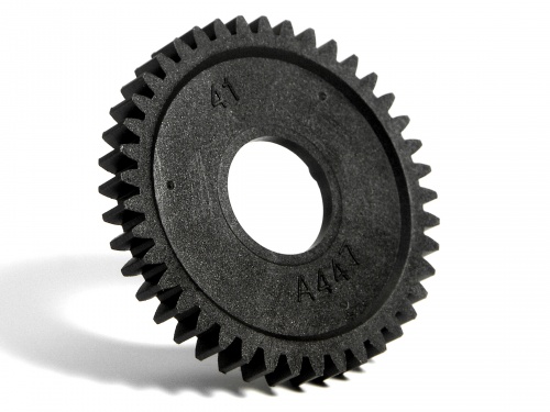

The flywheel is connected directly to the engine, on the opposite side to the pullstart. They are circular and usually made of aluminium or steel. If you turn the car upside down you should be able to see it's edge through one of the machined slots in the chassis.
The clutch is connected to the flywheel. The clutch BELL has the smaller "cog" or PINION gear on it. This is the smaller gear of the two - the larger gear is the SPUR gear. These cars do not have slipper clutches.
I hope that made sense and you now know where some things are and what they are called!

The big black thing with teeth is the spur gear, and if you turn it it will cause the car to move. The flywheel however, as the clutch is not engaged while the engine is not running, will not cause the car to move when you rotate it.
To find the flywheel lift the car up and look directly at the side of the engine opposite to the pullstart. Gently pull the pullstart and the flywheel will move. I'll find some pics for you and post them in a minute.
First pic is a flywheel, second is a pinion gear.
