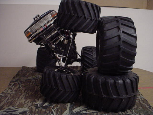

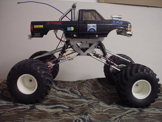

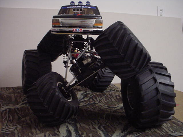

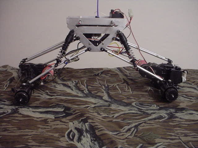

I've finally finished my first custom crawler. It has some problems due to low $$$ like: stock speed control and kind of high center of gravity, but other wise it is all handmade by me. Here's some Pics.

no offense but it looks like crap, sure its cool you made all your parts but you need to do some link configuration and shock mounting, like move the shocks down, shorten the upper links so that the lower links are paralell to the ground... that should help you out

no offense but it looks like crap? lol.i think the truck is cool i mean look at that thing flex... is it called articulation?

the thing will do ok on rocks but it just doesnt look scale, i mean its cool but wouldnt lowering it and mount the body to just above the wheels look better and it will have lower cg to so it will be easier to handle.

The reason it doesn't look right is it has a 1/10 scale body when the truck is more likely to be 1/8-1/7 scale so it looks a little odd.

uh so your gonna leave it like that??? but really it needs jsut some help............... the COG is too high,,, but leave it like you will, but it does noty look like a crawler

it needs to be lowered and it has to much articulation

yup arc needs to be somewhere in the 65 degree range, so make some limiting straps....then you can lower the chassis and re position the shocks

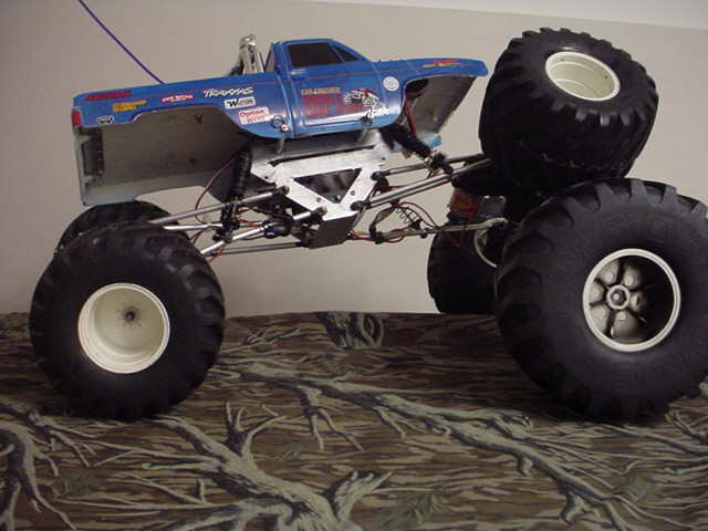

With a few adjustments I've made it a lot better! (according to you guys) I lowed it about a 1.5" and put on a bigger body and also limited my ARC. So here's some more Pics.

Very creative - With the changes, is it top heavy?

Not really, it has the weight pretty well balanced between everything.

Definately looking better! you may find that body to be too heavy for a crawler. I like the Clod bodies too for look but they are so heavy!
How does it do actually crawling?

It crawls pretty well for my first crawler. I had some deep ruts in the snow from my 4-wheeler and it crawled over them like a snake. With out the body it can climb stairs. Also, It can climb up very steep inclines. But it's kind of hard to tell because we got about 6" of snow and I don't want to ruin the Electronics.

Nice... Yeah, I would ditch the body and you've got a great first rig. as you run it you will see things to improve on it but it's a great start. Good job!

looking great! much better than before, yeah same thing with a body, get a lighter one, and mabye move everything a tad lower
