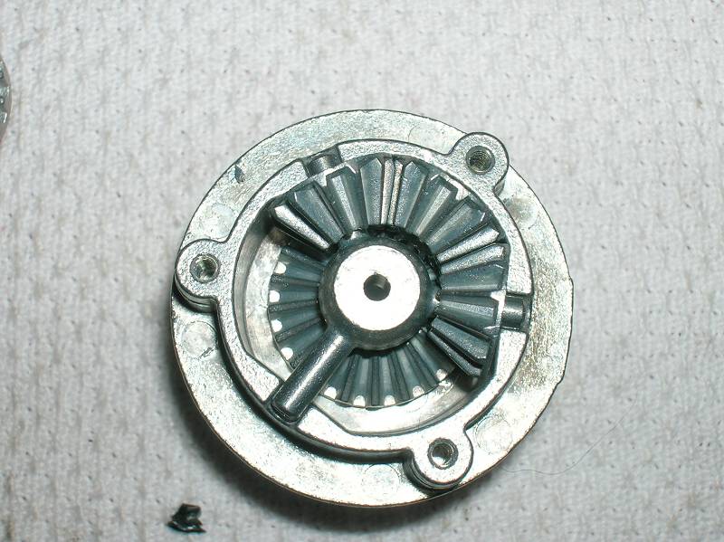

i dont know if this has been posted so ill post it anyways. i locked the diffs by putting one of the gears between the other 2.. better than jb welb or any other stuff and u can remove it anytime... thanks for looking....

hi, you can, but just put jb weld in and dont get it where the shafts slide in. only the spider gears
This is an alternative to JB Weld, it works just as well and is reversible.
It's how I lock mine.
