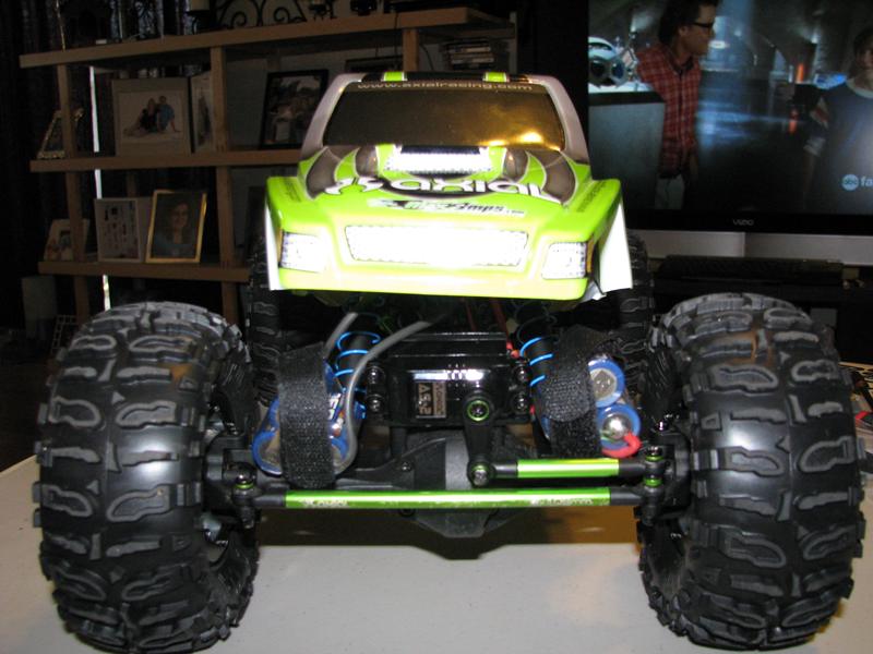

So ok I bought a AX10 today whoo hoo. Coolest part is my girlfriend who had no clue on what to get me for Christmas and wanted me to get what I wanted. We she is all in to helping me set it up for a Rock crawling. So I let her run it in rock racer set up and she broke the servo saver.
The question is does it need a servo saver or not. I was thinking about CA glueing the save in the front half so that it will not break What do you all think.

I have a Axial AX 10 Scorpion with a 180oz servo and I dont use a servo saver.Just think,If you have a servo saver and need all the steering torque as possible the saver will go before your steering turns thus pointless in having a good servo! I cant recall seeing one on a crawler with a decent servo
So to round things off in my opinion get a decent servo and loose the saver.

Congrats on your new hobby. I have a RTR AX10 that has had many upgrades since I got it two months ago. Do not wory about the servo saver. The servo that comes with the RTR is a High Torque servo with a metal gear and is very tough. I have been running the stock servo and have had no problems.
Here are some easy and cheap upgrades to make it rock crawling ready
Instal the 14T pinion gear that is included
Instal the front axle locker that is included
Get the Axial 55T motor (works with the stock ESC and is only $14.00)
Get the MAX Amps saddle packs [link]http://www.maxamps.com/MA-1600-6Cell-Crawler-Saddle.htm[/link]
Get the over the front axle mounts [link]http://www.tcscrawlers.com/ON-SALE-1-2-Off-TCS-Delrin-Axle-Plates-for-Axial-AX-10-Scorpion-2-each-p-16524.html[/link]
& use the velco straps that came with the RTR...put the velcro straps undr the plate and use a sharp knife to make two holes in the velcro where the screw go
Get some Losi Rock Claws
Add some weight to your tires
Invert your front shocks and move them back to the 3rd mounting hole
Get some softer springs
That should get you rolling.
Here are the latest pics of my RTR AX10

most of the ax10 RTR's came with a non saver steering arm in the bag of stuff that came with the truck

Yeah, loose the saver. Im running 333 oz. servo and no problems.
