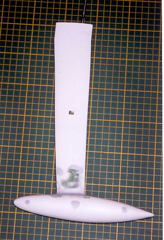

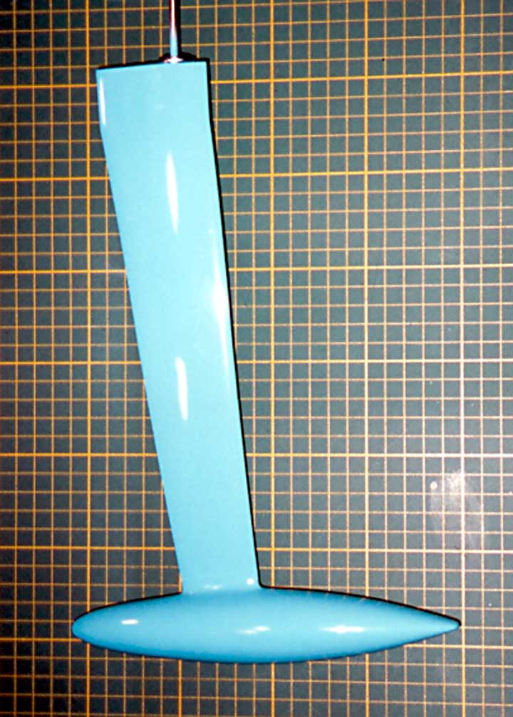

RE: Northwind 36
One thing you might want to do is reinforce the area where the keel bulb and the fin go together
There's only the one piece of plastic to support the lead wieght (3.5 LBS) If you hold the keel
straight out you can see the end of it droop
I used fibreglass cloth and epoxy on both sides of the joint to strenghten mine.

I did notice the keel thing. I CA glued the 2 plastic halfs together and am in the process of reinforceing the seam at hte top with epoxy.
