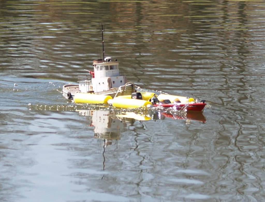

Go to the web and find Vac-U-Boat...he has a nice tug that I use for recovery boat for my T-37 & T-45 schooner. I put 12 foot of fly fishing line with a tennis ball and it works great and will pull just about anything even under sail. It was fun to build and it is great to have a the pond for other to play with.
I have found the best recovery plan is to have a well equipped rescue crew with me at all times. As the photos below indicate, I have a one team member for surface recoveries and another for below the surface recovery.
There are less expensive methods as some of the fellows have suggested. I posted a few of the more tradtional recovery methods as a contrast
