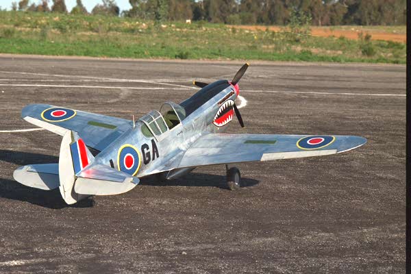

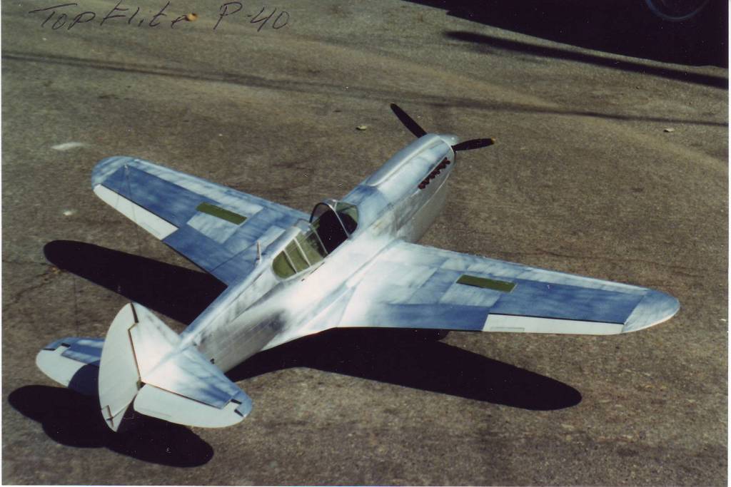

Just for information, and perhaps education.
I covered the whole airframe with silk, for strength; then doped until the weave was filled, then applied scuffed chrome monokote panals per whatever scale 3 views I had at the time. I used a scotchbite pad, and applied the adjacent panels 90 degrees to the adjacent panel (as much as possiblle) to emphasize the individual panels.
Les

I'll try again to upload the photo, but I haven't had much success so far.
Les

Even in that small photo your P-40 looks great!
I can't wait to see a larger photo.
Kudos, nice model.

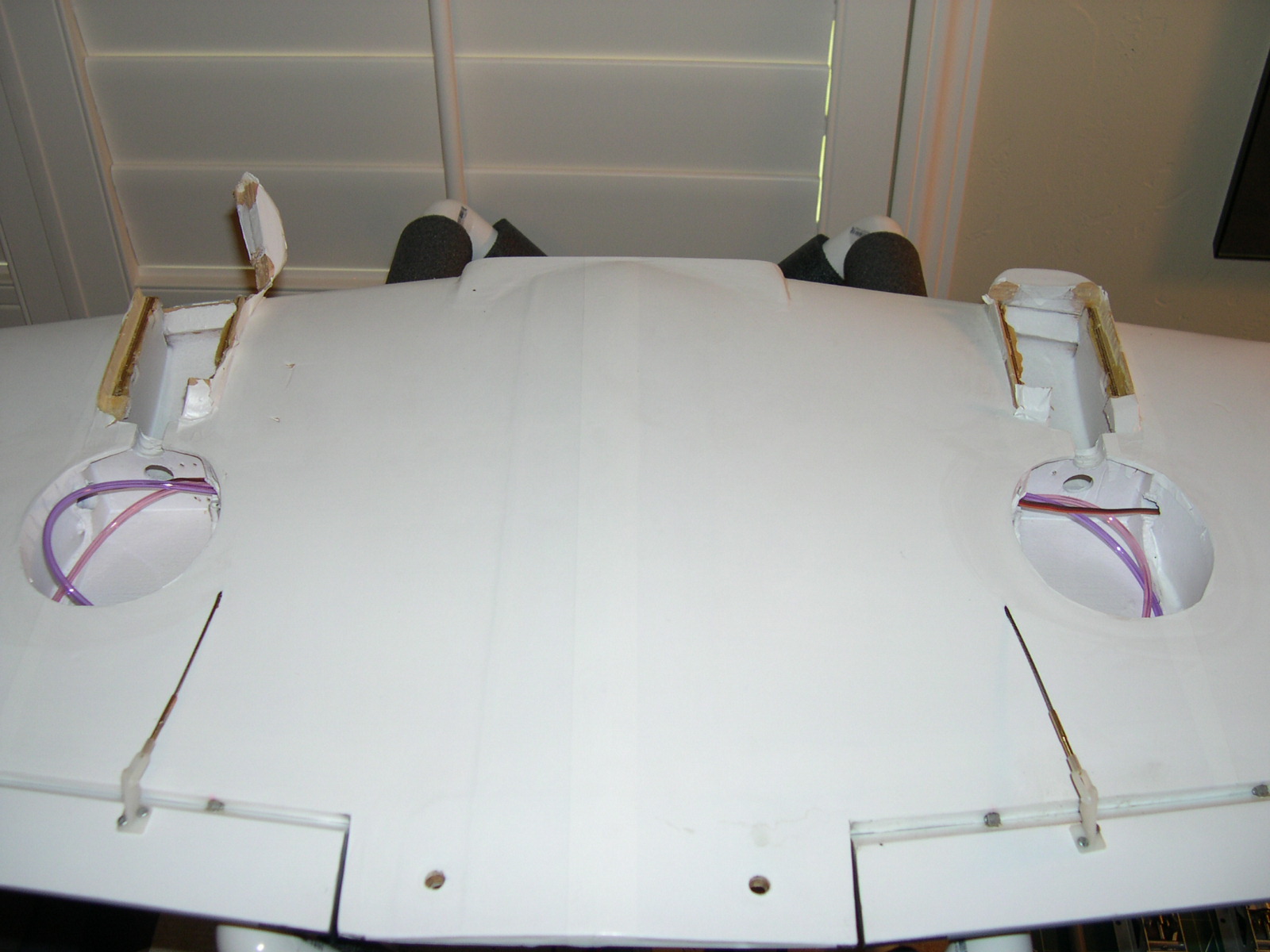

The Top Flite Panel Line Pen works OK.. Or an Ultra Fine black Sharpie seemed to be the same stuff..
They both come off with fuel!! you need to clear coat over them.. Oh, and the clear coat will also melt the pen marks so you have to shoot a couple of very light coats.. I used the LusterCoat Flat Clear.

Thanks, Larry, for the information and compliment. It looks like "click to see full size image" is about as large as I can post here.
P.S. The retract filler valve is located under one of the machine gun ammo hatches, along with ammunition.
