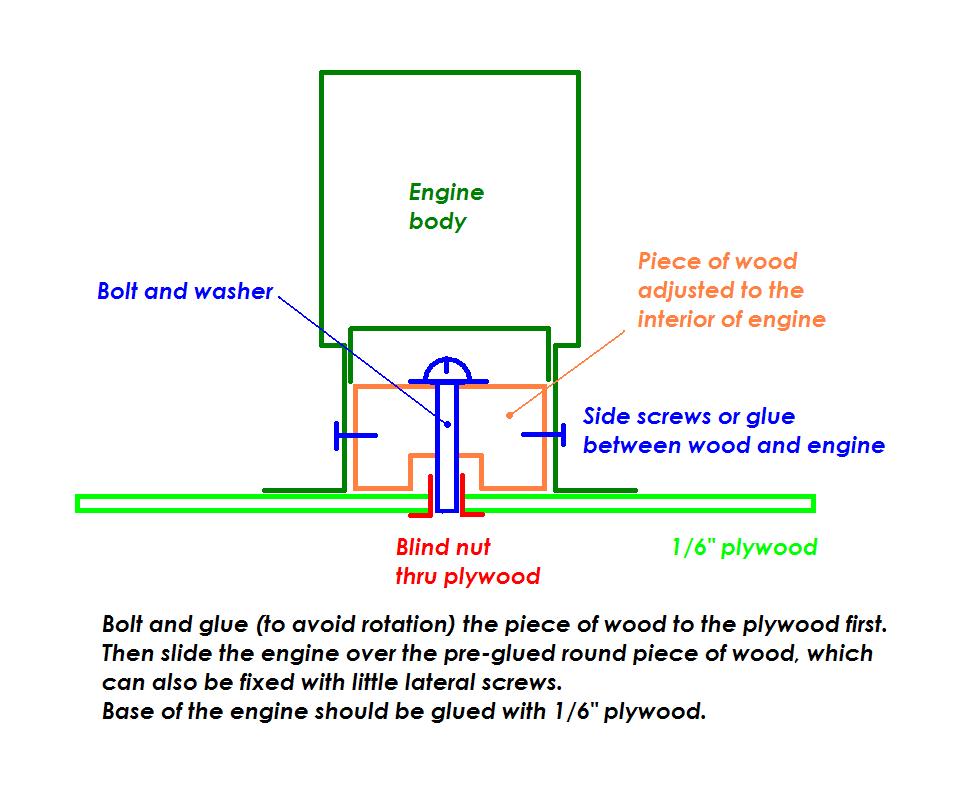

Lots of good, practical ideas here. Thanks! I still don't know exactly how I'm going to attach the resin cylinders to a 1/16" ply base. I was thinking of just epoxying them in place but am concerned about engine vibration. I could use the dowel idea but here would only be a 1/16" bit of dowel in a hole.

The dowel can pass deeper and more glue put on from under. Have 1/4" pass below.

The thing is that the dowel CAN'T go any deeper at least for the first two cylinders since base plate would already be sitting right on top of the engine mounting flange.

Lnewqban's Avatar
Joined: Apr 2007
Posts: 4,057
From: South Florida
Default RE: Finding the center
ORIGINAL: abufletcher
.........I still don't know exactly how I'm going to attach the resin cylinders to a 1/16'' ply base. I was thinking of just epoxying them in place but am concerned about engine vibration. I could use the dowel idea but here would only be a 1/16'' bit of dowel in a hole.
You are welcome.
What about this one?
Any bolt would need to be manipulated from outside the array of engines.
