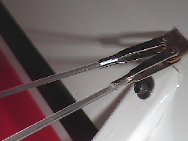

Old 02-08-2003 | 11:00 PM
rcmike57's Avatar
Posts: 7
From: Sammamish, WA
Default Nick Ziroli's Lace is great
Since you mentioned 4.5 scale, I suspect you are using it on the GR Ryan STA. Here's mine with the plastic lace "wires" as Nick Ziroli described in Apr 02 MAN. This stuff works great and with a little pretensioning (i.e. cutting the lace a little short so it's stretched), it looks a good a metal. Taking on and off (just unhook one end) is as easy as popping off the clevis. I bought mine in a local crafts store. It's Britelace by Pepperell Brading Company "BRT Mini Silver" and comes in 5 yrd roll for about $1.50.
Have a look.
rcmike57
