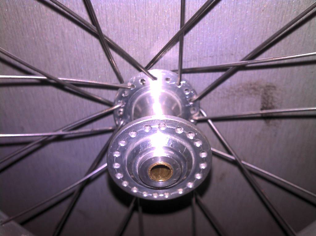

Hi guys does anyone have any drawings or pics of the hub drillings or plan for 40 spoke 1/4 scale wheels i have rolled some alloy rims and turned some billet hubs i just need to lace them together thans i advance stefan

Check out my thread on making spoked wheels.
http://www.rcuniverse.com/forum/m_26...tm.htm#2693952

I build my spoke wheels complete of metal.
If you need more drawings or details, please send me an email.

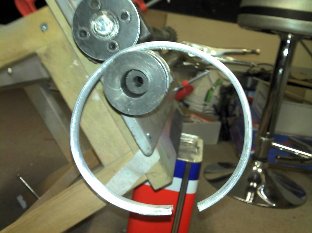

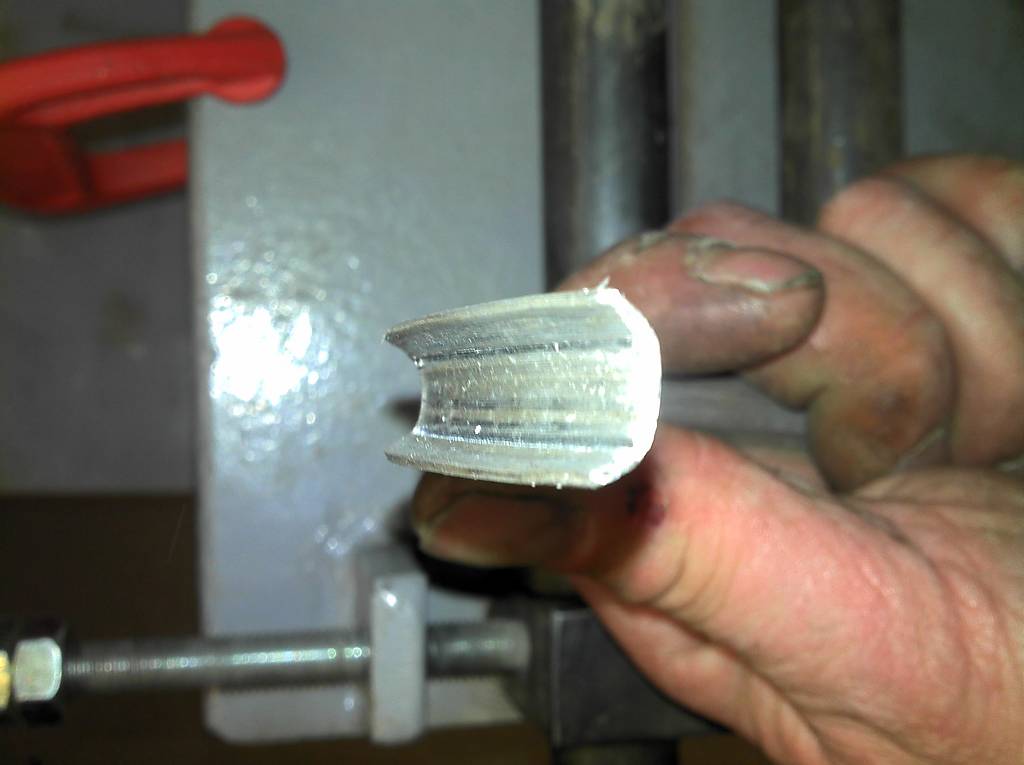

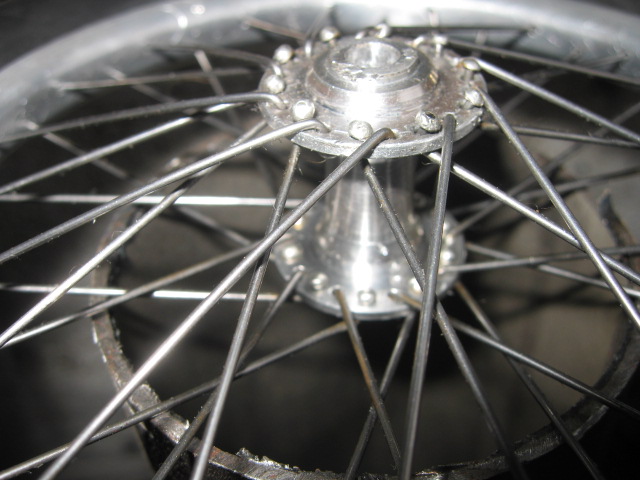

Thanks buddy the hole spacings for the hub were a great help thanks everyone for their input. well, here goes...

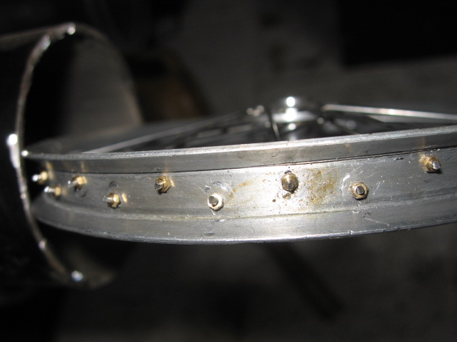

didnt realise the spoke holes in the rim had to be offset... time to make another rim!

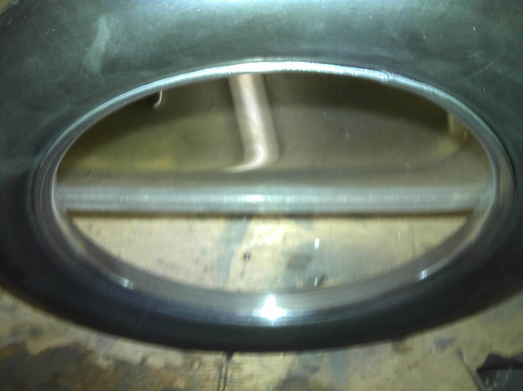

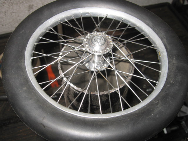

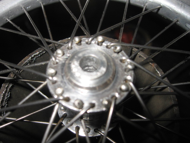

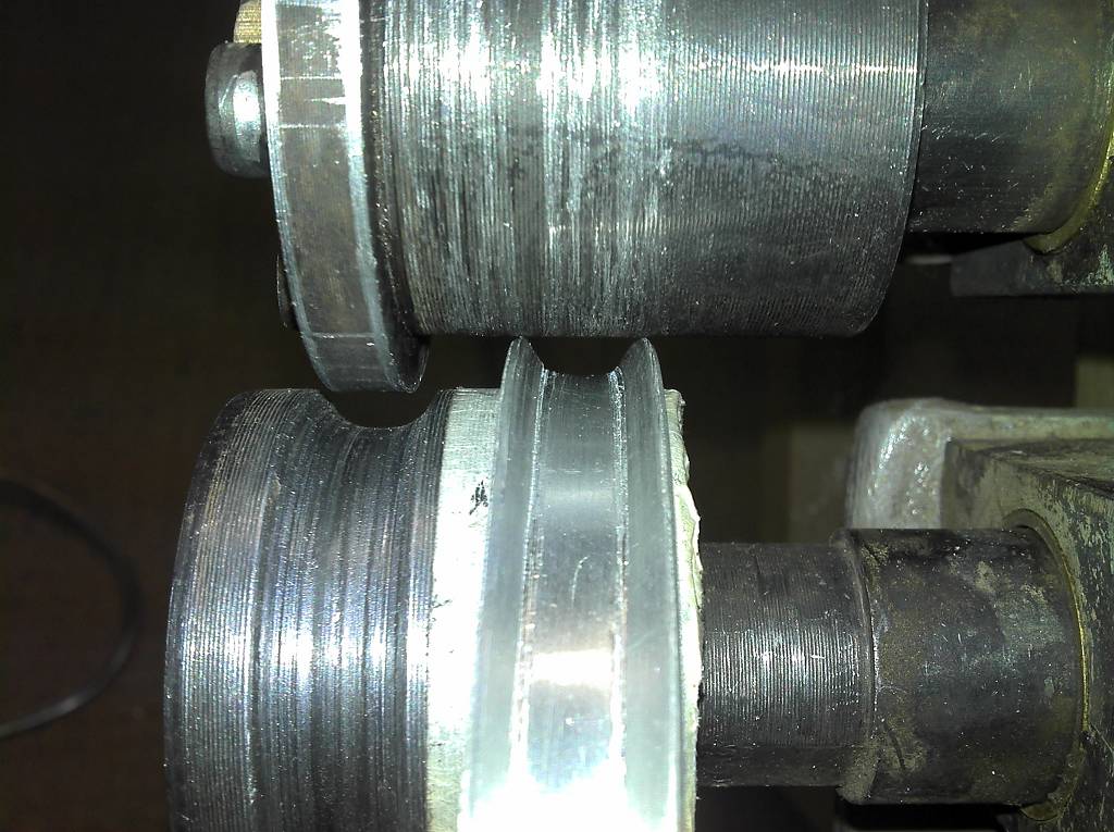

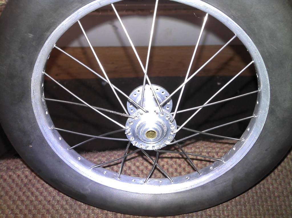

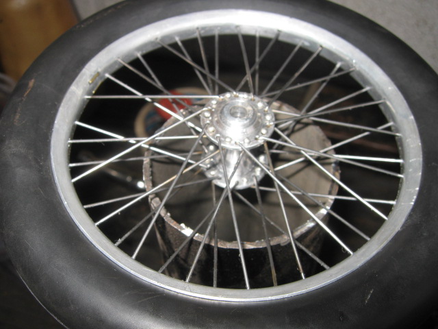

Hi all, finally got them right check out the pics. Quite tedeous running a 1.1mm die up 80 pieces of piano wire.... cheers for all your help guys, stef.

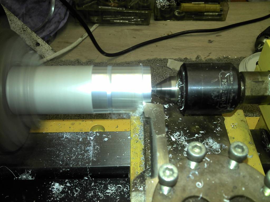

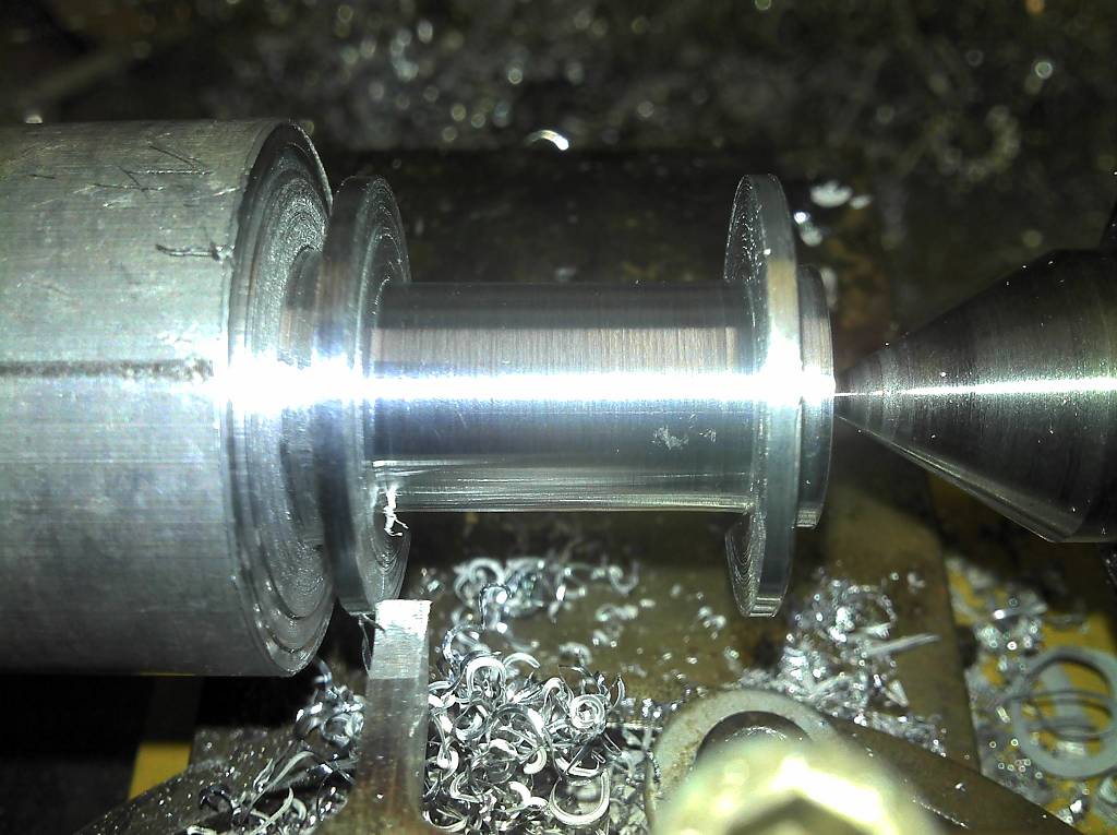

Turning the hubs.</p>
