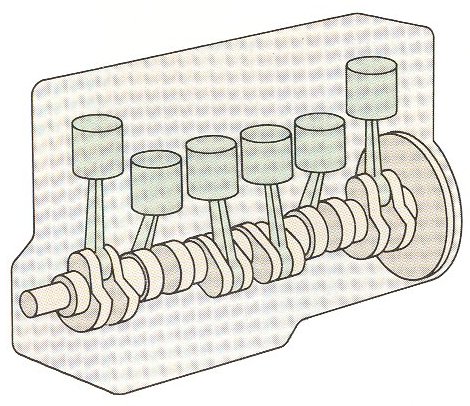

Here's an odd request - I'd like a photo or diagram showing typical intake/exhaust valve positions for an inline 6. I am at the "valve lifters" stage with my Aviatik's Austro Daimler and I DON'T want them to be at the same position!

One "solution" would be this: Since almost no one knows this answer, as long as you DIDN'T have them in the same position, I doubt that ANYONE would ever call you on it. That said, I'm curious as well!
So the key question is really what's the cylinder sequence?

Here's a start:
http://www.zyra.me.uk/firingo.htm
For modern Mercedes-Benz inline 6 engines the firing order is 153624
The following photo also suggests an answer:

Thanks Don - that got me off on a search. Turns out that the inlet and exhaust valves only open approx 10mm so, mine will only vary by 1/8".

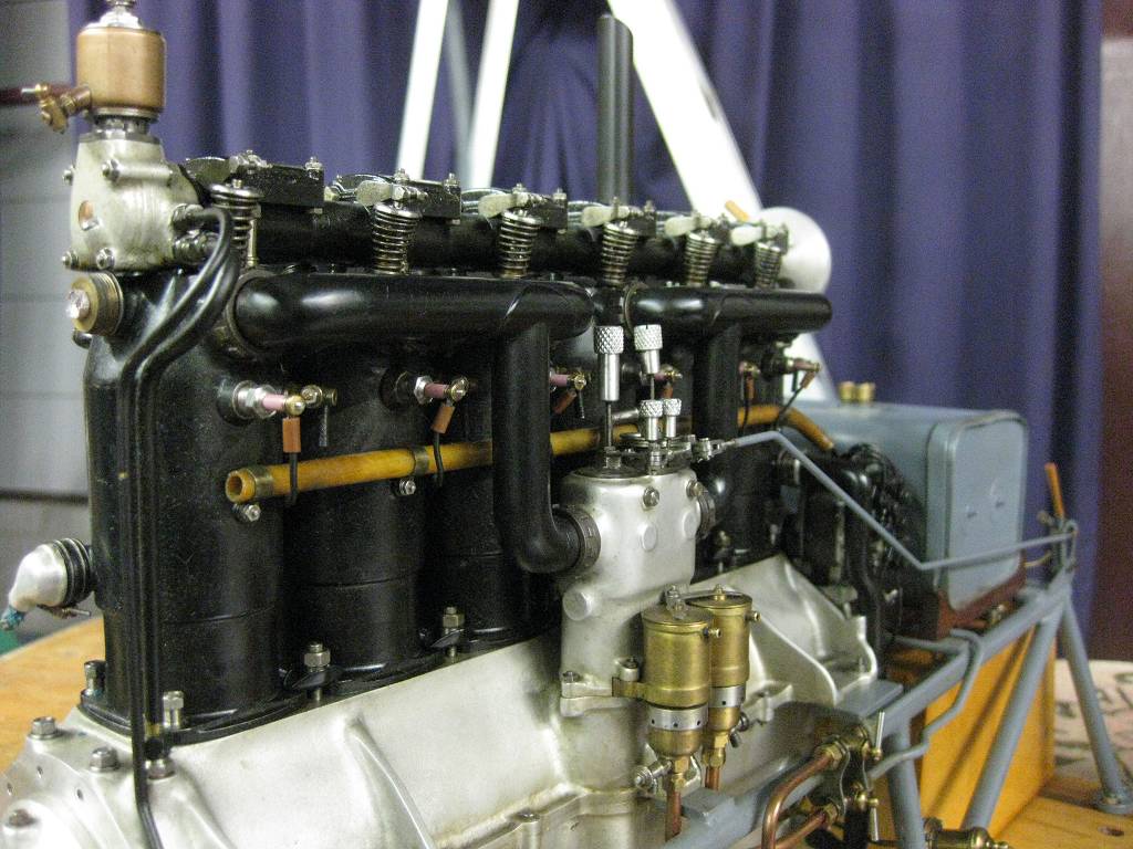

Hi Martin,
I think these photos can help you out a bit,
I took the photos a few months ago at a show where I saw this magnificent 1/5th scale full working engine [8D]
Teus

First of all, what an amazing work of engineering! Second, I think that those photos demonstrate is that it doesn't really matter how we modelers position the rockers since the difference is all but invisible.

Beautiful! Is that a 160hp Mercedes?
Yes Don, even with 1/3 scale planes, the valve only travel about 1/8". Go to 1/6 scale and it's only 1/16"!

ORIGINAL: Nieuport nut
Yes Don, even with 1/3 scale planes, the valve only travel about 1/8''. Go to 1/6 scale and it's only 1/16''!
What is true is that our eyes are very sensitive to symmetry. That is we probably CAN see when all the rocker heads are in exactly the same position. So all that's really necessary is to break the symmetry and it wouldn't really matter how we break it. Here's a case were being a bit "sloppy" might actually be a good thing.
