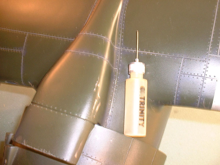

For rivets I usually use just plain ole Elmers glue. I have taken a Trinity oiler that the car guys use and dump the oil and use that as an applicator for the rivets. The rivets go on last and hold up very well. If you need to you can always go back and touch them up as needed.

There are probably many ways of applying raised rivets. The method I use is simply to apply drops of glue from the oiler. You can vary the size of the drop by the pressure on the applicator and the speed at which they are applied. A little practice will help quite a lot. It is a very fast method of applying rivets. I did an entire 101" B25 in a weekend. I have had this Trinity oiler for a number of years, I assume they are still available or at least something similar.
