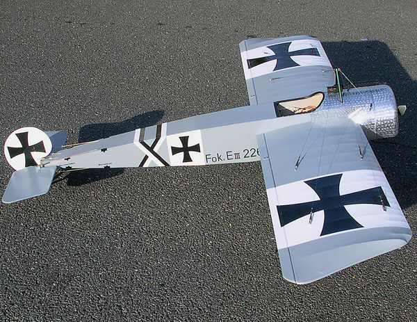

I've been waiting a week to post these photos! The first shows the metal cooking pot that I used for a cowl on my EIII as well as the random squiggle pattern used. The second photo shows the very nice 66" span AerodromeRC EIII which has scale outlines and full-flying rudder and elevator. I also like the way this model design uses the thin full-span ailerons to fake wing-warping.
It's really a very nice model...BUT my eyes are immediately drawn to the non-scale "swirlies" on the cowl. Why, oh why, do modelers who otherwise clearly know what they're doing, do this again and again on eindecker models???

Before I found a metal cowl, I applied FliteMetal to the BUSA ABS cowl. It's possible, but not pretty since you have to do it in sections. I also used it on the cheek cowls that I ended up making myself since nothing from the BUSA kit was useable on a scale EIII. I carved molds for the cheek cowls out of balsa, the stretched heated styrene over them. I remember it being very hard to get the FliteMetal on smoothly. But then I was a complete model building novice back then.
It's also possible to do the patterning on FliteMetal/Aluminum tape but you have to go easy.

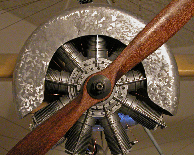

Here are those two photos. Again the first one shows what the random squiggles should look like (more or less) and the second photo (of the AerodromeRC 66" EIII) shows the nicely done but historically inaccurate "engine turning" swirls.

It was part of a cheap camping cooking set I found at the Army Navy store. The cheek cowls were made by pulling sheets of heated styrene over balsa molds.
Any comments about how you did the ''engine turning''? Did you use the dremel brush in a drill with steel wool trick, or something helse?
I borrowed an electric eraser from my brother-in-law who is an architect. But I'm sure there are many other ways. I also bought a couple of cheap aluminum pans from the $1 store to practice on. Once I had a pattern I was happy with, I moved on to the metal camping pot. What worked best for me was to apply 2-3 second "bursts" of the eraser and then move randomly to another area, doing this until eventually the whole cowl was "filled" to a density that looked good.

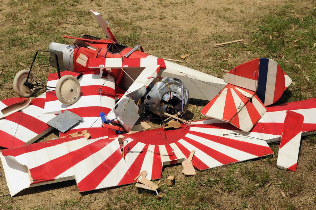

Well, it's not so pretty any more. After almost five years of nearly constant flying, I "re-kitted" my Puppeteer today. On the fourth flight of the day something went wrong and the model would only spin in a tight left spiral. Back home after the crash, I reconnected all the radio gear and the rudder, elevator, and throttle servos are all working normally. But there is no response on either of the aileron servos (one plugged into the aileron Rx slot and the other in the FLAP slot for differential). Could I somehow have saved it with just rudder inputs?
I also did one flight on the EIII but banged up the UC on the landing.
Upon further examination of the radio gear, I noticed that no matter which servo I plug into the aileron slot, that servo doesn't function. Does it seem possible that a single channel can fail on a receiver (or the Tx)?
