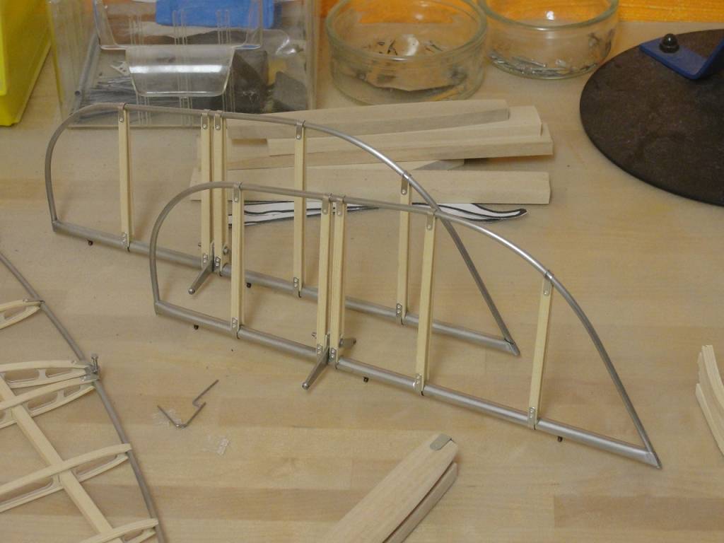

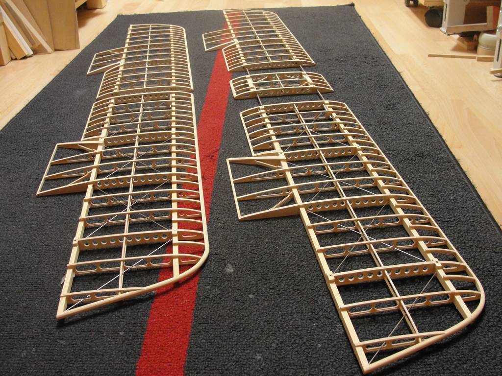

thank you so much for all the great solutions. I first tried vacuum forming, but the styrene cowling went much too thin. I decided to go with the fiberglass/epoxy solution then and it turned out very well, it is strong, not too heavy and (hopefully) will accept paint very well. I post some pictures of all the DH2-Parts done so far, next week I'll begin constructing the narcelle. Best regards.
