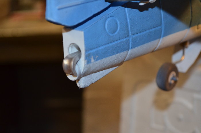

Hi Redtail: My next step is just to see how this apparatus works in flight. I think it will be just fine. I believe that the Avenger, also built by the "Grumman Iron Works" also has a similar tailhook arrangement as the F6F Hellcat and maybe other planes too.
What we need, especially for the larger planes, is a reliable gearing device that can convert the rotary motion of a servo to a linear motion of a device attached to the tailhook. I was looking into a gear that looks sort of like a comb that would ride back and forth in some sort of frame. I'd have to work some more on that idea, but if anyone has other ideas, this is a great place to share with us as there might be a number of modelers who would like to do something like this on their planes. It is definitely doable.

Hi All: took the Hellcat up today, checked out the new flaps and tailhook action. The flaps worked great, probably look better than they are functional, and the tailhook didn't blow off, and deployed and retracted just fine. The only issue is, as feared, that the airstream blows the tailhook almost straight back, even at approach speeds. So, there is some work to do there. What I am going to do in the interim is tie a piece of fishing wire to the tailhook that will keep it in place when it is deployed. That will at least make it look the way it should when it passes by the flightline in the dirty configuration.
I'll post a few pics, nothing really all that good, but I'll try again when I get the tailhook position figured out for flight.
davegee

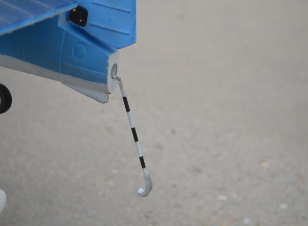

Thanks, Scale, that might be my next experiment. So far today I have tried using a spring that goes over the robart hinge on the tube (gets hung up coming in and out of the fuse), an elastic string, fishing line, and now a small magnet that is on the fuse, and a screw inside the aluminum tube of the tailhook to attract the magnet as the tube comes up and out of the fuse. But if the magnet idea doesn't work, I'll try fashioning a torsion spring as you suggest. Appreciate the input.
I was pleased that the tailhook came in and out of the fuse flawlessly on a number of tests. It just has to hang down without blowing back into the slipstream. I don't want to add weight to the tailhook, and I think if I did it by adding weight, it would have to be a LOT of weight to keep it down, but I'm just guessing at this point.

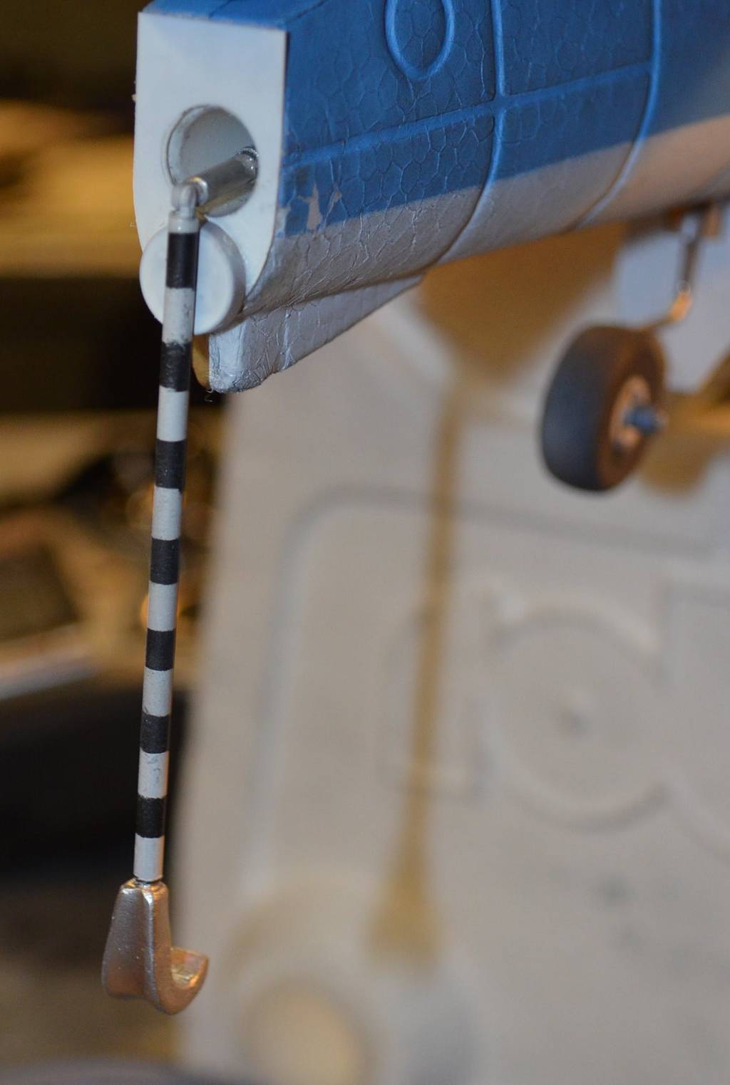

OK, I think I found a solution. I had some 1/2" diameter magnets lying around, so I glued one to the plate just below the opening for the tailhook. I glued a small bolt inside the aluminum tube of tailhook in the area where the magnet is, and as the tailhook comes out of its storage tube, it snaps onto the magnet below it and stays in position. I think it will resist blowing off of the magnet even with the airloads on it as it is flying. It is no problem at all for the tailhook to overcome the magnet's hold on it and retract normally into the fuse. I think this is now a workable system. I'll fly it in a couple days when I can get out to the field and see how it does.
Cheers
davegee
