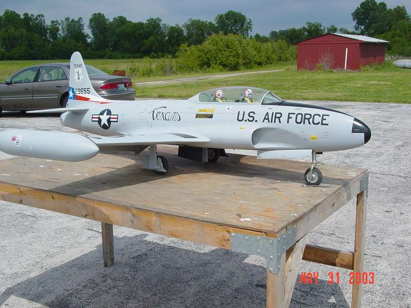

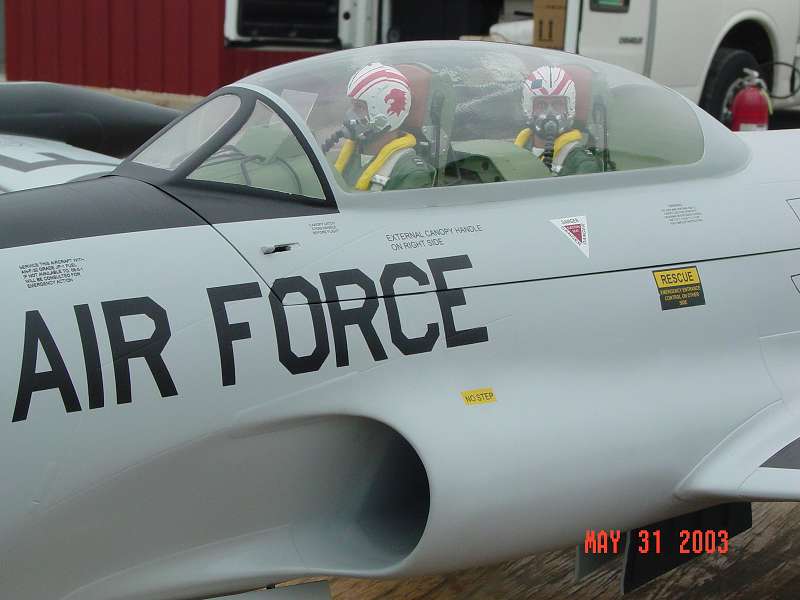

Well, true sound is available for some models and it isn't done with speakers. My T-33 sounds almost exactly like the real thing. There are true turboprop engines available for models as well. Unfortunately, this is probably about the only way you will ever be successfull creating a truly authentic sound for a model airplane.
