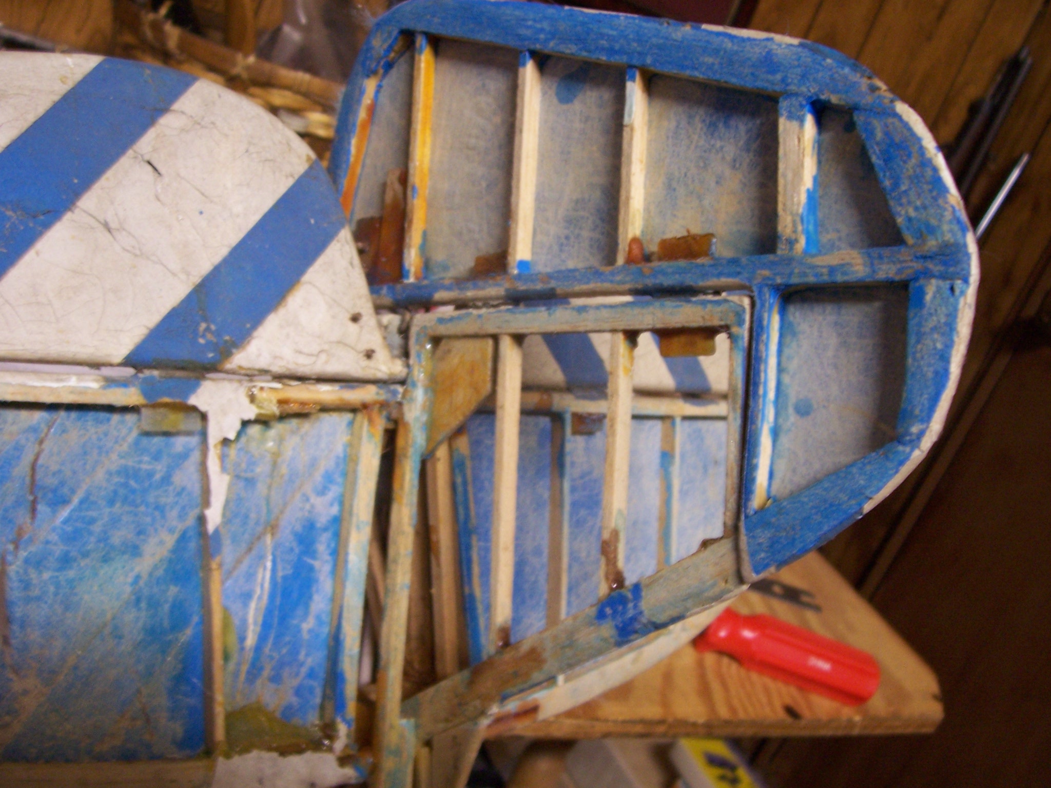

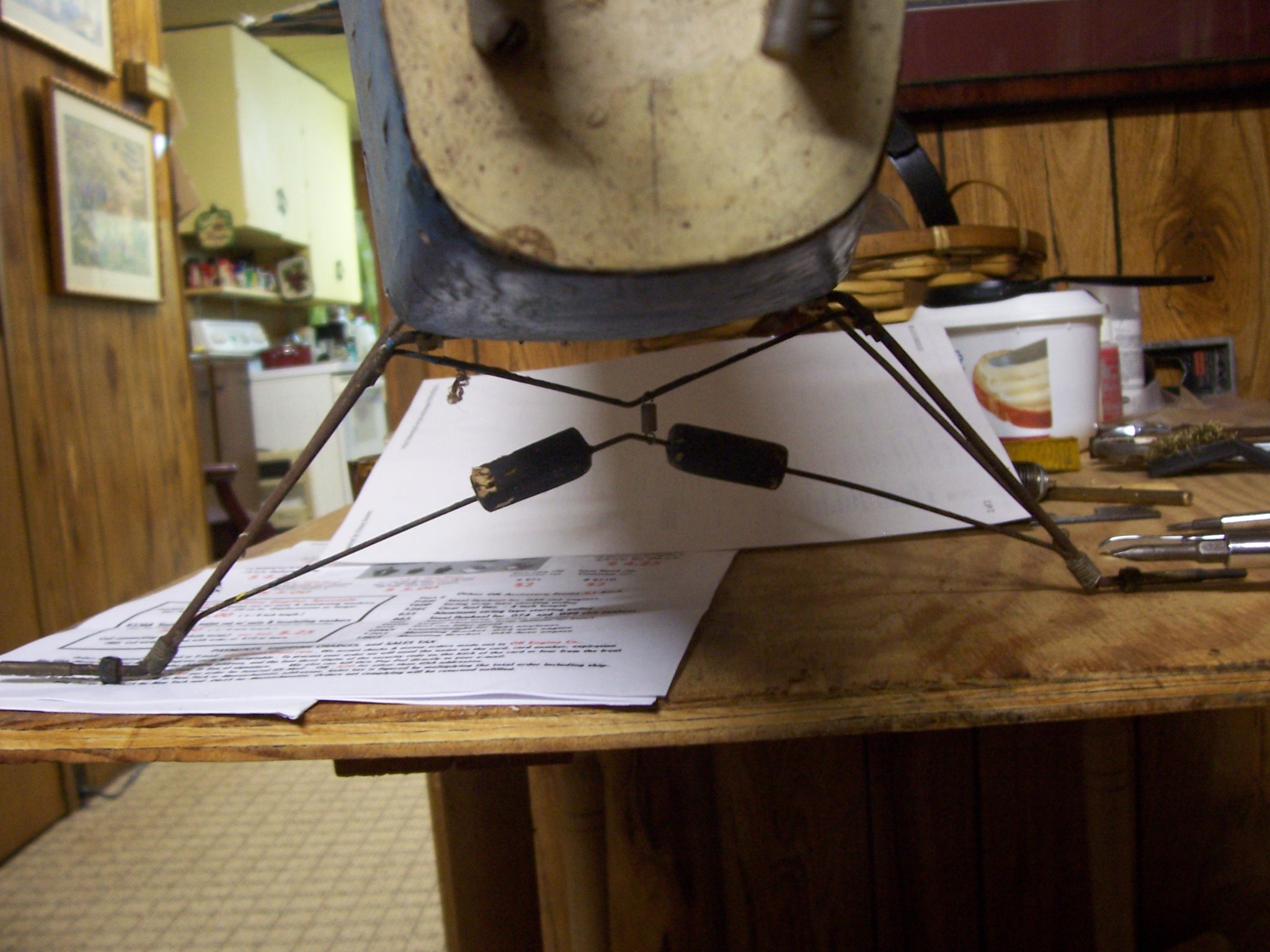

Hi all -
I was given this 70" model ~15 years ago and it was old then.
It doesn't match current Sig (http://www.sigmfg.com/BuildManuals/SIGRC3Cub.html), Great Planes nor Berkeley plans in detail and I hope someone can help I.D.
I'm wondering if Sig's design has just changed over the years?
It does have the dowel-between-halves stab like Sig, but shapes of curved parts, cockpit wing fixture, cockpit rear bulkhead cutout shape, no vertical members in aft fuselage trusses are unlike Sig.
There seems to maybe have been some repairs/mods - it has a (homemade?) fiberglas tank cover front cowling as shown and a couple upper deck formers that appear to be "aftermarket".
I can post more pics if helpful.
Thanks.
Terry

Old 12-15-2013 | 08:19 PM
TFF
Joined: Oct 2006
Posts: 4,183
From: Memphis, TN
I would say it is Sig where the builder thought he knew a better way. Or did not understand.

Old 12-17-2013 | 02:19 AM
Joined: Jun 2008
Posts: 345
From: Christchurch, NEW ZEALAND
Terry,
Looks a lot like SIG to me.
Tail, rear fuselage, and cockpit rear bulkhead shape are identical to my kit and plans, and also clipped wing plans that I have.
The verticals in the fuselage are marked as optional on the SIG plans.
The front wing hold down wires are different, they should run to the fuselage sides then down the sides, but as you say the front has been modified.
Dave H

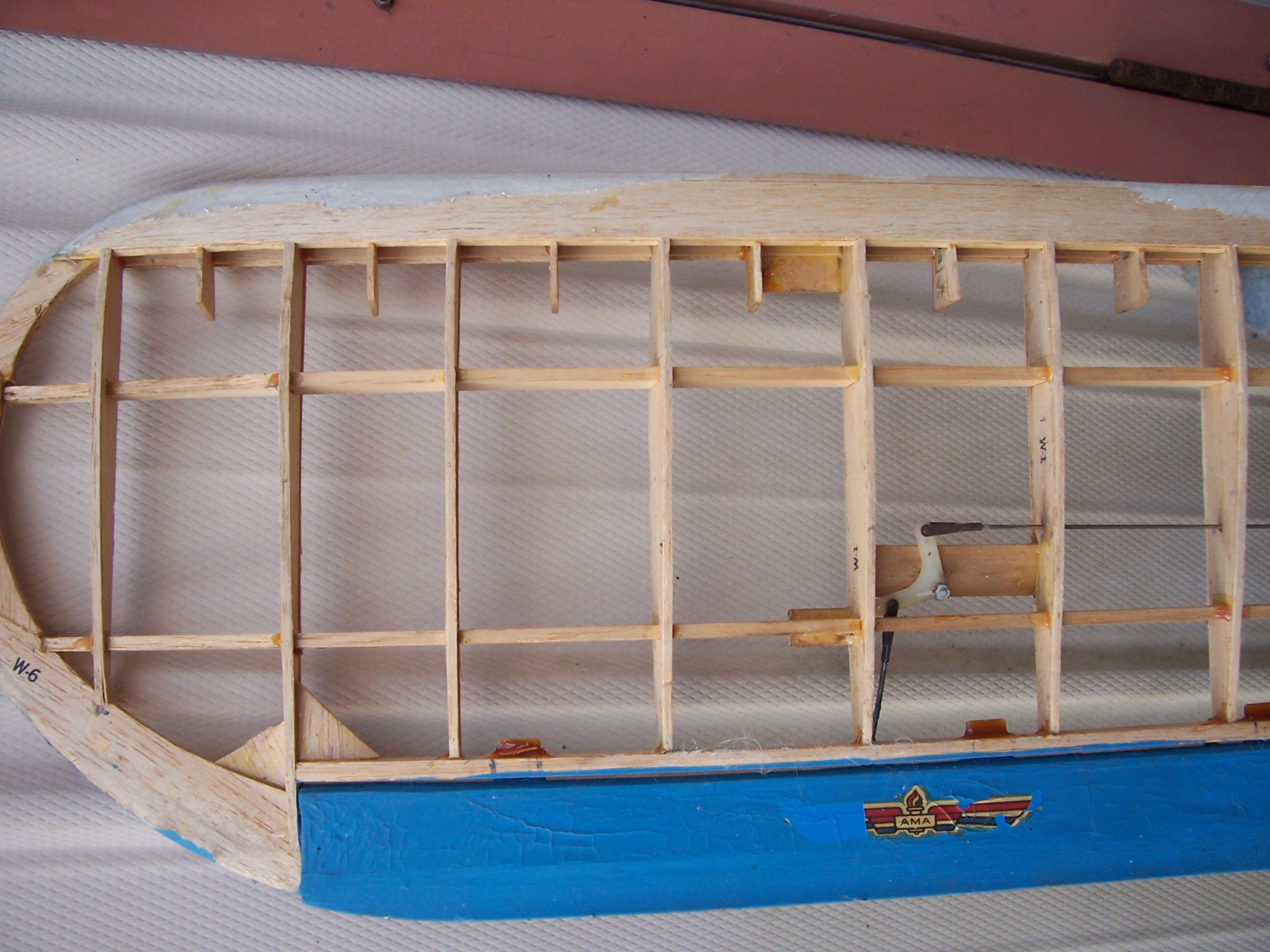

Have you got the wing?
SIG's spar set up was fairly unique.
Dave H
Old 12-17-2013 | 02:10 PM
Joined: Nov 2013
Posts: 30
Yes, I do Dave -
Tip ribs are capstripped top only, all others top & bottom.
Supplemental spars at leading edge sheeting.
Maybe other details show.
Terry

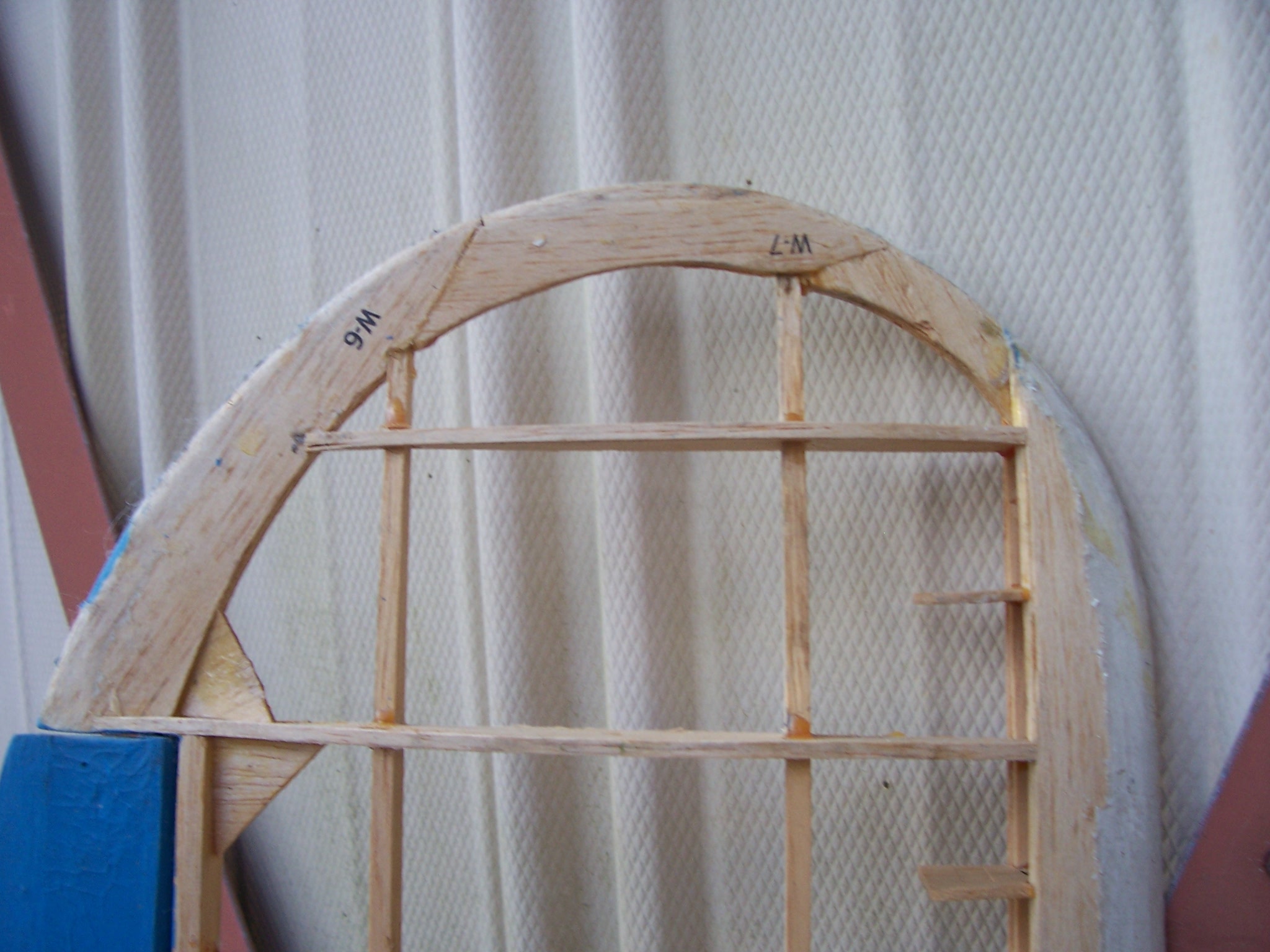

ID:	1948437   Click image for larger version
ID:	1948438   Click image for larger version
Old 12-21-2013 | 03:06 PM
Joined: Jun 2008
Posts: 345
Yep, that's a SIG wing.
Dave H
