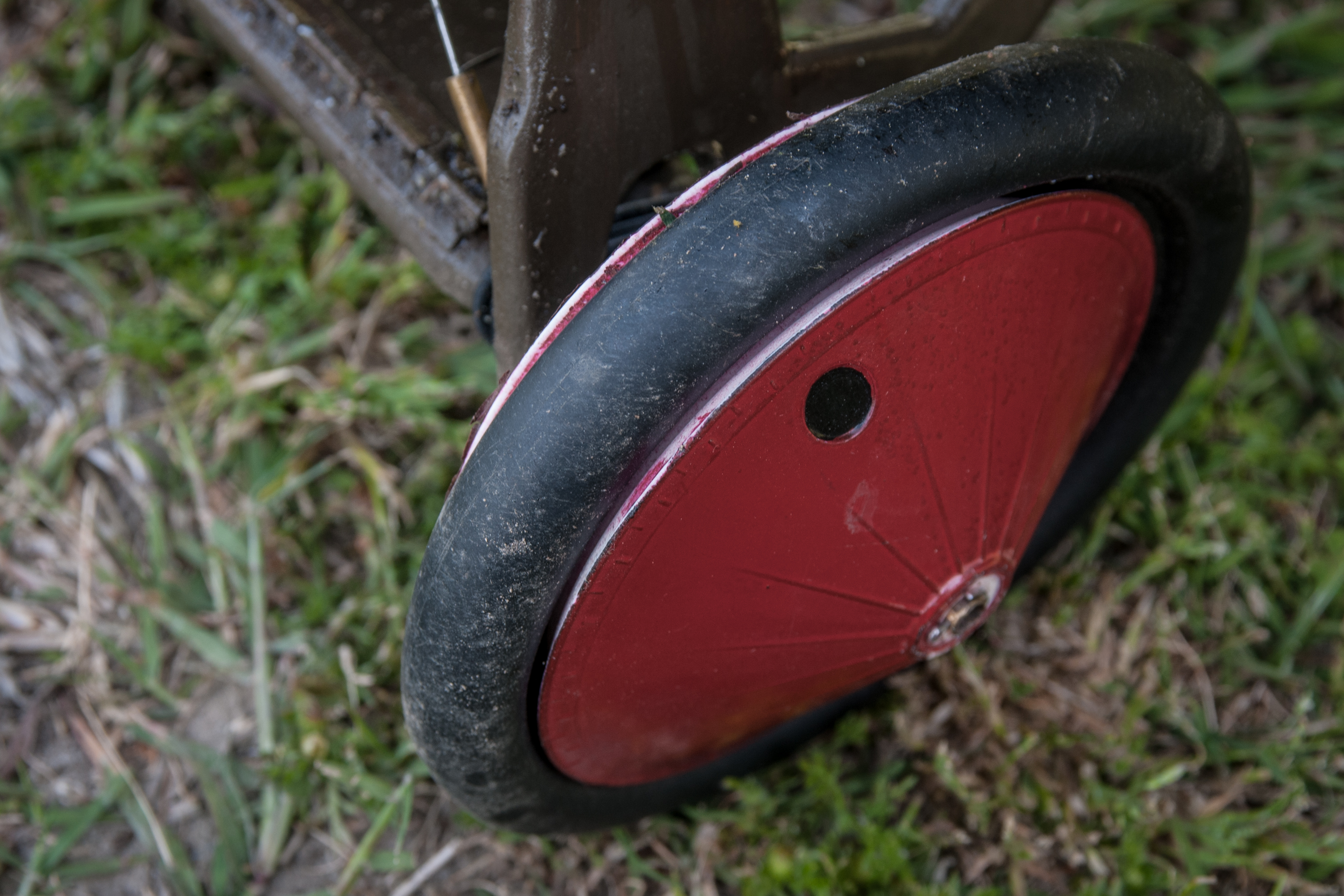

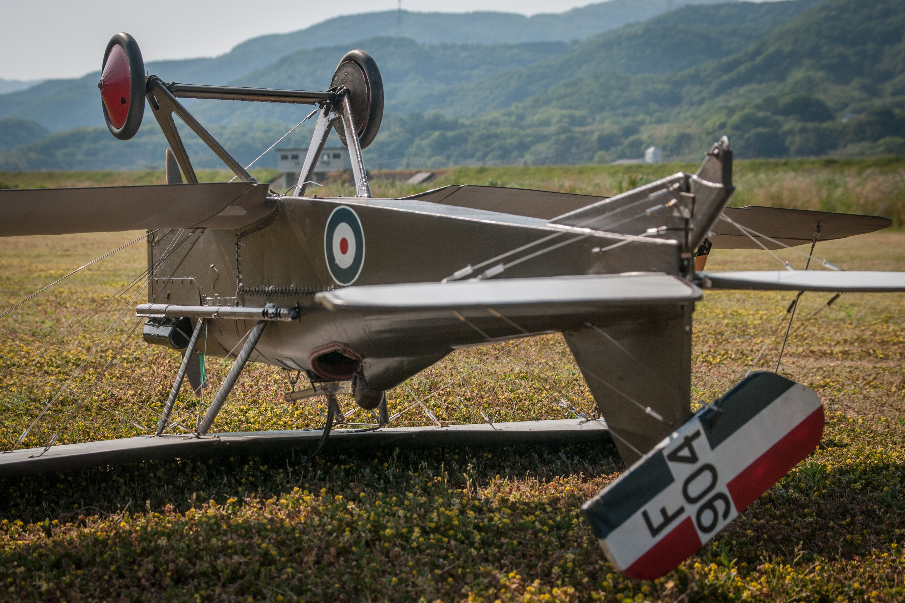

Four more flights. Three and a half more landings. Finally a calm day after weeks of 10-15mhp winds. So up the SE5a went. I'm still learning its ins and outs, for example, turning with the rudder also requires significant elevator to keep from diving. And it'll definitely turn tightly. No loops or anything fancy yet, but it turns well in either direction and flies hands off. I managed two flights several weeks ago, and two more today. The first take-off wasn't the prettiest; it really needs a long, scale run. The landings was smooth as butter. A real joy to see with a WWI bird. The second take-off was just about perfect, but as you can see, the landing wasn't pretty. It came in just a tad too hot, with the tail just a tad too high...I was fighting a bit to keep it steady in a sudden gust...and then the wheel may have hit a divot in the field. Well, it flipped right over and torn off the rudder. The rudder itself seems undamaged. But I'll have to dig out the remains of the three Robart-style hinges. Some of the rigging wires were tugged out of position, but that's probably just a matter of pushing the cabane struts back in place. More annoying is that one of the Flair wheels seems to have split.

Extracting broken hinge points.......
1. cut off exposed knuckle of hinge
2. bevel the inside edge of a brass tube (a size that just fits the barbed end of the hinge) and put a couple or three cuts in the end of the tube and use this improvised tool for drilling out the broken hinge
I have used this on more than one occasion and it works for me.......
