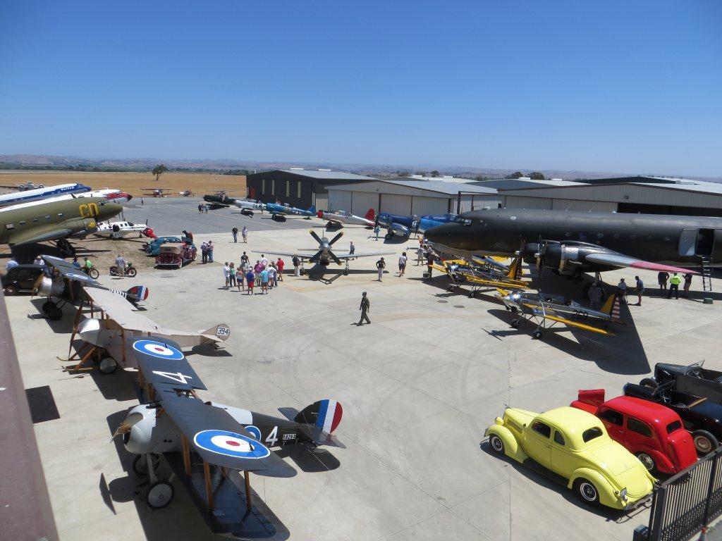

The photo below shows aircraft attending a little BBQ luncheon last Saturday. The three WWI aeroplanes are resident at the field and were flown in a demo that morning. I'm working on posting a video of the flight. The photo is just a preview if I can learn to make friends with Mr. Youtube.

Yep, that would be Coutches' airplane. There are only two H model Mustangs flying so not too hard to keep track! The other one is in British colors so it's not difficult to tell them apart. I could tell the Mustang in your pic was silver just wasn't 100% certain if it was an H or not.
I'm not familiar with Airdrome. The WWI airplanes in the picture are all replicas. I believe the Camel is by Jim Appleby and the other two were built by Antique Aero.
Don't know the history of the P-51. I had the impression that it was made from parts.
