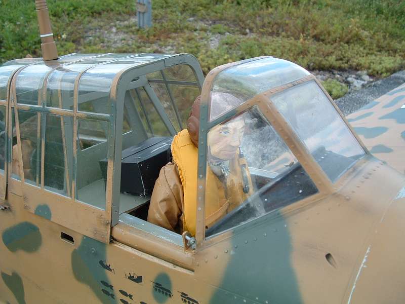

Default RE: How to hide the Rx switch...
Jim, as higheronnitro suggested, if you have access to the cockpit mount the switches and charging jacks inside as I did on my Stuka. Both switches and charge jacks are mounted in that simulated battery box, which is hinged and secured with a magnet.

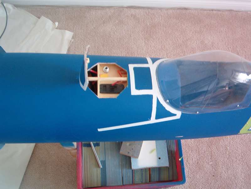

I used the main fuel hatch on the top deck of my Corsair to hide those necessities. The only thing showing is a big ugly home made latch. If it wasn't for that latch, it would have been a perfect solution. But I still think it's better than having all those thing exposed.
(Also... Please disregard the bloched up paint job.)
