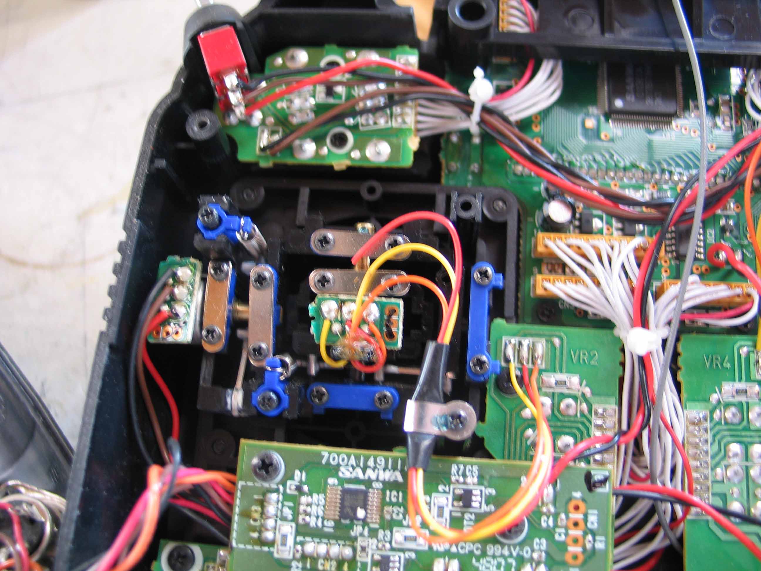

For a second time I've experienced a transmitter failure on the Airtronics RDS8000. Once before a wire broke inisde the Tx gimbal resulting in the total loss of the model. Today, it appears that the same thing happened on a second RDS8000, though luckily this time on the ground.
I've been getting my Sopwith Snipe ready to fly again and noticed something odd about the aileron setup. It appeared to be just fine and then the next time I switched on it was as if the settings had changed. That seemed weird enough. But then the ailerons stopped responding completely even though the rudder, elevator, and throttle were still fine. So to confirm my suspicion that it was a Tx problem I tried with another model. And sure enough, the rudder, elevator, and throttle worked but the ailerons went to a non-neutral position and then ceased functioning.
And the functioning never return. So I believe that if I open up the RDS8000 I will find a broken wire on the aileron gimbal just as I did before. I'm lucky that this happened AFTER the first flight.
This is definitely a quality-control issue with the RDS8000. Sure, I have used this radio for many years, but the wires are really thin and the attachment points don't deal well with repetitive stress. Eventually, the wire WILL fail.
At this point, I don't know what I'm going to do. It seems foolish to get another RDS8000 (which amazingly is still on the market). I could upgrade to the SD-10GS, but frankly, I don't know if they are any more reliable unless Airtronics has specifically addressed this concern while designing the SD-10GS.
Alternatively, I could make the move to Futaba or JR. But that would mean also buying a new set of Rx units.
Looks like I won't be flying for a while.

The wire issue is well know with the RDS8000 radios. It was really bad on the early ones but a tweak to the wire length improved things considerably. A dab of hot glue or thickened epoxy on the solder joints will protect them from the repeated bending, fixing the problem for good. This should be done at the factory, but it isn't.

Here's a link to the RCU thread describing the last failure (in 2013). The photos show the broken wire on the aileron gimbal and the description sounds identical. Yeah, I think it's time to say good-bye to Airtronics. It was a good radio to learn on but now that my models are more serious, I need a more serious (and more dependable) radio.
http://www.rcuniverse.com/forum/airt...e-failure.html

Three of us in our club bought RDS 8000 transmitters when 2.4 radios first came out. All three have experienced the same wire failure though only one failure resulted in the loss of an airplane. I repaired these three transmitters using more flexible wires in a different configuration and I doubt these will fail again. There was quite adequate strain relief in the original configuration so that wasn't a problem with our transmitters.
For the record, the original problem was the result of using wiring that had limited flexibility configured with too short of a loop / cable to allow for the required flexibility.
Most stick assemblies regardless of mfgr. use a similar wiring configuration to what Airtronics uses. Airtronics just had poor implementation of the wiring in this case combined with a poor selection of the wire they used for the application. With a proper repair, there is no reason to fear the problem repeating.
What makes one wire "more flexible" than another? Did you switch to a thicker gauge wire? The wires look incredible flimsy to me. Some people have suggested putting a dot of hot glue or epoxy over the solder point. But in my case the wire broken in the middle. Obviously this is the result of repetitive strain (from a too short loop).

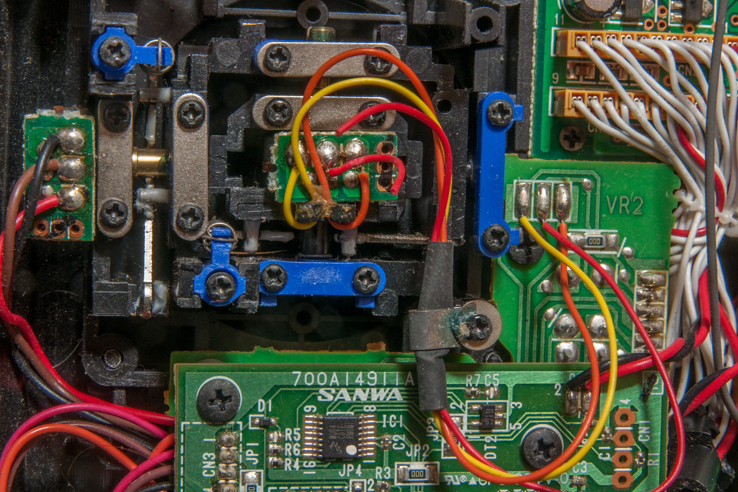

I just checked and it was the same red wire on the aileron gimbal that broke. This time it broke a bit closer to the solder point.

I had a red wire failure on my RDS 8000 also. And, like Don's, my wire broke some distance from the solder joint. So a daub of hot glue wouldn't have changed anything. I didn't lose an airplane, but it could as well have failed in flight as during shop setup.

Foodstick makes an important point. Not all wire is created equal. Copper, as used in electrical wiring, presents a real dilemma. Yes, it's an excellent conductor. Yes, it solders readily. Yes, it's fairly corrosion resistant. Yes, the cost is nominal. But does it resist fatigue well ? No, as a matter of fact it's quite poor in fatigue.
So, why do they use copper when the fatigue life is poor ? Because all the other properties are superb and most applications don't involve much flexing. Plus, designers have found ways around the fatigue problem. The "way around" is to make wire with many small strands rather than just a few large strands. The many-strand wire flexes easily and the individual strands don't see as much stress as a wire with few strands.
The new wire that you use needs to be of a type that is designed for applications where flexing is a concern. Rather than using the first wire that comes to hand, I'd suggest that you do some internet research and find wire that is designed for long fatigue life. I just did a quicky google search and the first candidate source looked pretty good, although I don't know the price or what their minimum order would be.
http://www.daburn.com/2671UltraFlexi...E15681692.aspx
One last thing: Don't make the mistake of thinking that bigger wire would last longer. Yes, a bigger would be stronger for a single pull. But the flex life of a bigger wire over a given radius is not as good. Try to use the same size wire as you found in your transmitter. somebody else in this discussion might be able to look at the wire and tell you what size it is. I'm no good at that, but think it is in the 26 or 28 gage range.

As far as how the repair was done, I doubt very much if they change to a different wire. They probably just add a bit more slack and maybe the globs of hot glue (if that wasn't already there).

The soldering skills aren't terribly demanding to fix it yourself. I've sent a transmitter to Airtronics twice for repair and have gotten about a week turnaround time. Once was for a broken battery connector on the circuit board of the RDS8000, and the other was because the SD-10 won't work with the Real Flight simulator. BTW, I found out after $25 worth of shipping both ways that it isn't capable of working with any simulator because the voltages of the trainer port are different. The Airtronics tech could have just told me that had he known.
As for trading up or not, look at it like this. You can probably repair the transmitter you have and sell it for about $40. So the SD-10 package will cost you $320 total when you allow for the real world value of your radio. Or you could apply that money to a different radio in the same price range. The $300ish price slot is extremely competitive, so there are lots of good radios to choose from. If you believe the best value is in Airtronics, then go with it. If not, go a different route. I do realize you have receivers to deal with too, but they'll sell on the used market too.
From looking at it, it seems like the tricky bit would be to make sure that the dots of solder don't touch neighboring dots of solder and that's a matter of a fraction of a millimeter.
