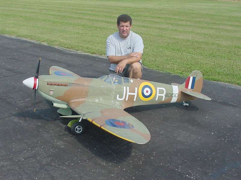

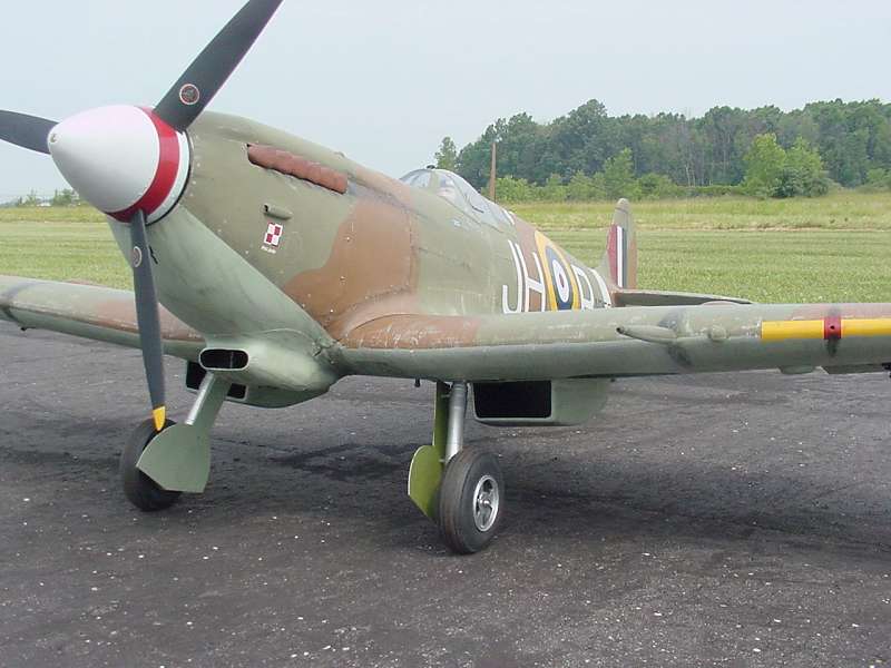

Old 12-31-2003 | 01:59 AM
My Feedback: (28)
Posts: 817
Received 7 Likes on 4 Posts
From: Waterford, MI
Default RE: why not scale props?
I came close..
A 24" 3 blade flies my Spit.
The plane will fly on a G 62.. I used a Q 100 to spin this prop. Should be a 26" prop though. Pretty close.
