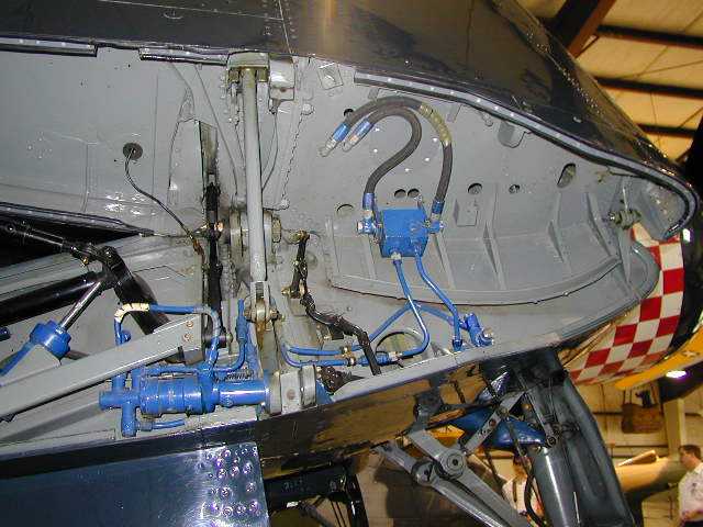

I’m in the planning stage of making folding wings on a 1/6 scale Corsair. My idea was to make it as scale as possible. If it worked on the full size it should work on the model. On the Corsair this will be 1 big air cylinder in the outer wing and a small one for wing lock in the wing stub. I was planning to use a sequence valve (door open – when gear down U.P.3) from Ultra Precision
The project is a bit down the road so I don’t have any pictures or drawings yet.
