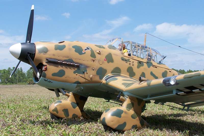

Buy Robart Large RoboStruts. You can get them un-trimmed so they are long. Buy the fork end version. Cut them to length. Run them into maple blocks on each side of the wing. You can bore the perfect size hole with a 5/8" Fostner bit. My son has done this and has been flying the Stuka for about 4 years with no problems.

Leo,
Glad to hear the Stuka is still flying. Will you attend the Joe Nall this year?
Nick
