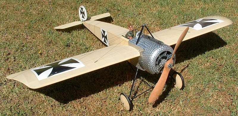

Tim, if you think the undercarriage on a Sopwith is a pain, TRY AN EINDECKER!!! What a nightmare! I am SOOOO glad that I've finally got that part of the project behind me!
Joined: Apr 2003
Posts: 210
From: Dublin, IRELAND
Very impressive work with the undercarriage Don! Looks like an EXACT miniature replica of the San Diego Eindecker's gear.
I've already gone ahead and ordered some cable lugs at my local hardware store. I plan to follow your example with the joints. How did you make those beautiful scale fairings??
I see you've also installed a bellcrank system. Are you playing with the idea of switching to wing warping after all?
The fairings are made of balsa soaked in thin CA to make them a bit more resistent to crushing, then primed. The little straps are made from FliteMetal aluminum tape. Finally, the whole assembly is painted "Lichtblau."
IMHO the three keys to a realistic looking EIII are 1) a good dummy engine 2) good undercarriage and 3) a suitably busy top deck. All too often scale(ish) models of the EIII seems to have wire gear, no dummy, and a featureless top deck with a cheap looking gun glued unrealistically to the top (instead of being seated into the cowling). The Eindecker only APPEARS to be a simple model. I believe now it is (or can be) one of the most challenging WWI scale projects. In so many ways mine is still just a "sports" scale model.
As for the wing warping levers in the U/C well for now these are just for show. But I tried to make it sturdy enough and with sufficient movement that I COULD -- if I ever get around to it -- switch to a scale wing with wing warping.

Tim, just gorgeous!!! You obviously know exactly what you're doing. Any chance you could give us scale newbies currently building EIII's (e.g. Trev and I) a leg up by providing some close-up shots? Yours has that wonderful delicacy that original had -- I'm afraid mine will somehow seem heavier even though I've used scale outlines.
Joined: Jun 2003
Posts: 521
From: AdelaideSouth Australia, AUSTRALIA
Well...uhum....its actually not mine...i'd be wrong to claim it.
its a K&W model and yes it is exquisite. almost museum quality in detail and finish.
there's a video..
www.cmfc.rchomepage.com/EIII
so, alas, i dont know what im doing....lol...my bad?
but the post was more to show an eindekker, not to claim as my own... the upper and lower rigging posts and assy are very heavy...still, my model's CoG was too far back at first.
tim

Indeed I agree, what a fantastic looking eindecker! Is that a kit or did you scratch build it??
The scale I've chosen for mine is 1/5 th. So far I've completed the fuse and the tail feathers..not being too satisfied with the first wing panel I built I've discarded it as a useful experiment and am starting on a more authentic scale wing.
This being my first scratch build project and first wing warper at that I'm naturally somewhat inexperienced, especially concerning control surface travel.
It would be a big help if you could say how much up/down travel you use on your wings (and the tail feathers) and perhaps describe how this crate actually flies/ is coordinated rudder nessecary?
Of course some close up pics would be great!

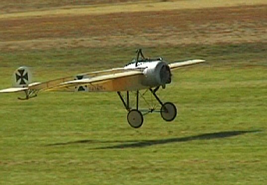

yeah 28% is ok....its actually quite tolerant on the position...
even midpoint on the wing flies fine.
the flying characteristics were very different to anything i've flown...and could catch you off guard if not careful.
First the rudder is ultra responsive. it is very efficient at steering both on ground and in the air. In fact i used it almost exclusively for turns, coordinating the ailerons just to keep from losing height.
aileron turns cause rapid height loss and they are authorative enough, but hardly useful for a quick rescue...so the moral there would be to not get into any trouble that requires a quick aileron response.
the plane wind vanes alot also.
if the wing warping isnt ligned up, it'll roll over on takeoff and airspeed and aileron control isnt authorative enough to quickly adjust...trust me i know this one.
you need to make some washout in the wings also, i did this using the rigging tension.
after flying around a few times and getting a handle on it, it's a great time!...and those low speed, low alt passes take everyone at your field back to 1915.
oh, anohter thing, i used a pretty small 4 stroke in mine, actually smaller than the spec (a 0.54 TT)..and the plane weighed over 9 lb. Due to the large diameter wheels and heavy undercarriage it flew very well even with that modest powerplant.
i just thought of another one...the angle of the fuse whilst at startup can starve fuel to your engine, so be sure to run richer than you think- or when adjusting the mix lift the tail to parallel with the ground...do the same for balancing- it's easily overlooked...
FYI the warping cables need to come around the pulley one full circle before exiting- my main worry was a cable slipping off when under no load...so the top rig needs to be fairly tight.
Cheers..
Tim.
Oh, and yes, checkout K&W...they are fantastic...the only thing is the cost in shipping..this baby cost me $350US of so, then another $600US to get it here....

i'd say that a 40 might be ok for a 1/6th scale model flown scale like.
i had a saito 40 special in my kyosho 'stang that weighed about 2.7 kg and it flew very well.
also, the scale cowl didnt allow much more than the 54 i had in the eindekker anyway..perfect fit actually...who knows how anyone got a 60 or larger 4 stroke in there..
Tim.

Well i can tell you that the positioning of the servos and the linkages for the wing warping are very difficult, as the rudder and elevator is pull pull wiring and these get in the way of everything...plus there is very little room in there to boot...but it can be done!
did you view the video?
i'm not sure what closeups ive got...i sold it off when i got sick of tuning engines, cleaning fuel, tightening screws and having to lug the trailer out to the field to fly gassers.
Now i go to a small park and fly almost silently!....no regrets!!
I'll see what photos i have of it...if you dont hear from me about this, then it means i havent got any useful ones...
Tim.
