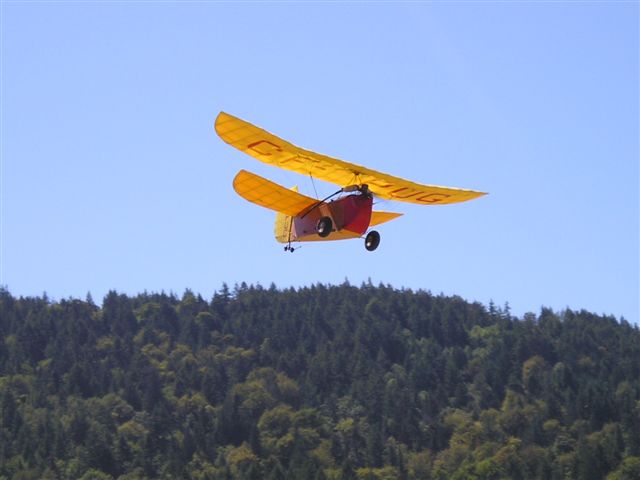

I test flew this bird for a guy, 1/4 scale. 72" mainplane, for those not familiar with it is a model of a homebuilt, there are no ailerons, rudder only, no elevators, there is a servo hooked to the trailing edge of the wing which moves it up and down to change the angle of incidence, more angle and the plane goes up, the real ones were banned because they had a nasty habit of tucking the nose in and under and going inverted with no way to gain control, this bird flew svery well Mike

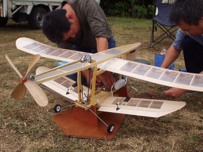

Mike, the design concept looks similar to this model in Japan designed over a hundred years ago.

actually, they fixed the diving thing.you can still get plans for the full-scale here [link=http://www.valkyrie.net/~flyingflea/gallery.html]http://www.valkyrie.net/~flyingflea/gallery.html[/link] I often daydream of building one, but as often as I crash models, I probably shouldn't.

I have never seen that bird, the "flea" properly named Pou du Ciel was designed in 1934 by Henry Mignet, it was probagly the first homebuilt, Mignet clained that anyone who could build a packing case could make one, it was grounded for 2 years until the problem of diving was sorted out but now some of the newer ones are back flying again Mike
