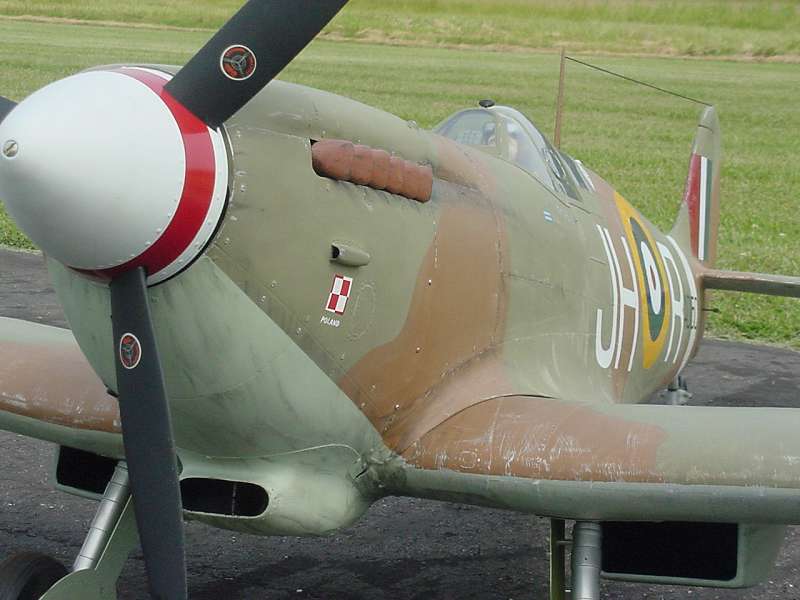

I fly a FiberClassics Spitfire on a Quadra 100 with a 3 blade prop. It flies fine. I use a Mejlik 24-10 currently, but may try a 24-12 soon enough. Looks good on the ground. Its a 102" plane. Prop is 2" shy of "Scale" I think.

I don't know the dia of the Macchi prop, but assuming 10-11', at 1/4 scale that's 30-33"; @ 1:4.5 scale (roughly what your Spit is), it's 26-28"
