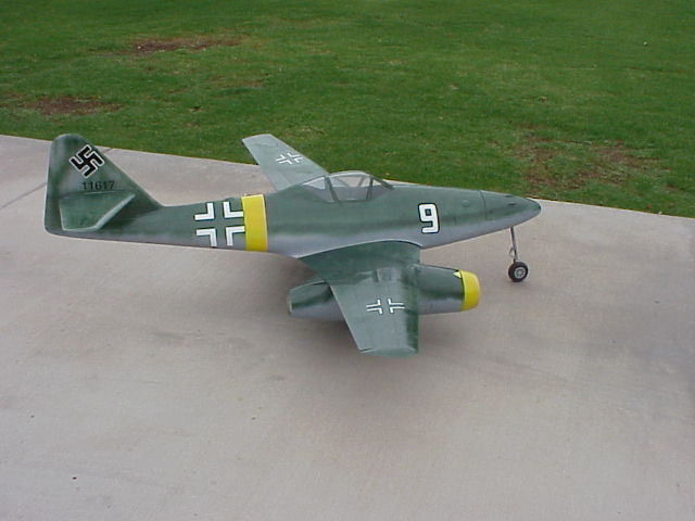

Hi,
I am looking for a source to buy two 1/6th scale WWII German style iron bombs for my ME-262.
TIA,
Vin...

If you have drawings, you could cut them easily out of foam - unless you're planning on dropping them....
Great looking 262 by the way! Did you scratch build or kit? Can you give some specs on that bird? - size, engines, other ordinance?

Try this link: www.franktiano.com/index.html
I'm not sure of the scale, but they do have a "German" bomb.
Great looking 262!

I agree with Schwoop, make them with foam, if you are going to drop them; I would glass them and use carbon for the nose. I love your paint job, what did you use? What did you use for a clear coat?

Thanks Dave, Frank has 1/5 scale stuff, may go with it though.
Craig and the snake,
The jet is from an Airworld Kit, it is fully molded and very complete out of the box. This is the elec version and will be powered by two hacker B50-16L motors with jeti / hacker esc. Schubi fans and 2x 18cell 3000hv packs.All up weight is 16.5lbs. Off the shelf Robart gear and struts. Nothing special on the paint job, its plasticote automotive paint from spray cans, the markings came from aeroloft. This particular scheme is from Major Walter Nowotny, a fighter bomber unit that carried two 550kg bombs under the nose. I was just planning on using the bombs for static shots.
Vin...

Hi Vincent, Nowotny did´nt carry bombs under the nose of "Yellow 8", he was a fighter pilot not a bomber. I could see a shot of some Commando Nowotny´s jets carrying two dropable fuel tanks. Take this in mind if you are planning to enter in a scale contest, because the shape are very different.
Congratulations you have a great plane, is my favorite. I am scratch building one in 1/7 scale.

Javier,
Yes you are correct. I have a desk top 1/48th scale ME-262 with this same color scheme and it has two bombs attached. No scale contests for me but I did install the bombs anyway. Kommando Schenk was the group that carried bombs. I do have another ME-262 in the works and it will be accurate scale, Gelb 3. I had the Experten decals blown up to 1/6th scale, this jet has the checkerboard on the tail.
If you go here on the e-zone, there is a thread where I posted the pics of the 262 with bombs.
http://www.rcgroups.com/forums/showt...370#post493370
Thanks for your interest.
