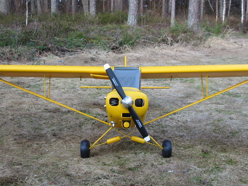

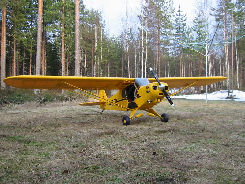

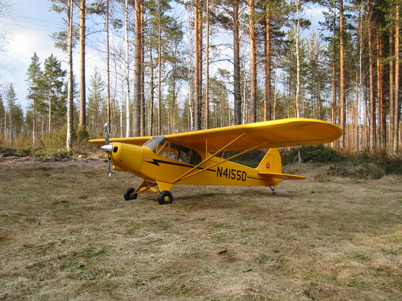

OK, Sorry for the delay, here are the pictures of my Super Cub -conversion, based on Sig Piper J-3 Cub kit.
Modifications:
- Tail feathers redesigned
- Working flaps added
- Front section of the fuse redesigned
- Own fiberglass cowling
Specs:
Wingspan 104 inches, weight 16,5 lbs (7,5 kg)
Saito FA-120S, Master Airscrew K 18x6, Futaba servos (5 x S148 + 2 x S3010), Multiplex 12-ch. receiver, doubled NiCd receiver batteries (6,0V 1700 mAh)...
One of the pictures shows also our flying field´s radar antenna
Modifications:
Specs:
