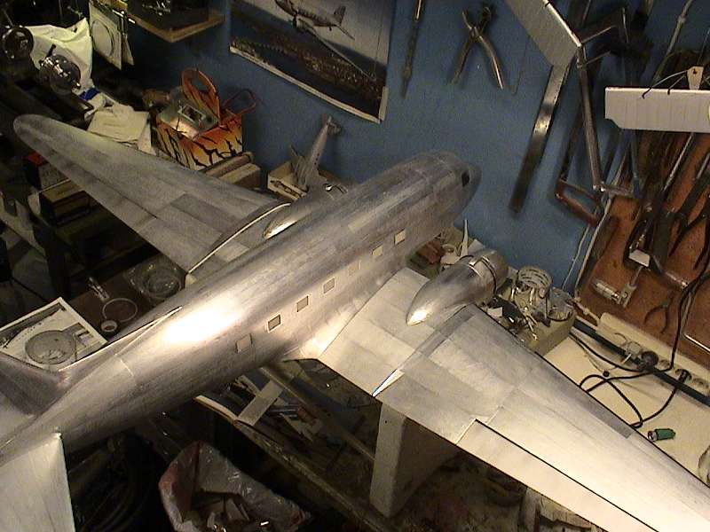

Hi!
Using Oracover chrome. sanded down on a glass surface and put on...panel by panel.
And some aluminum duct tape (same as Flite-Metal).
Regards!
Jan K
Sweden
